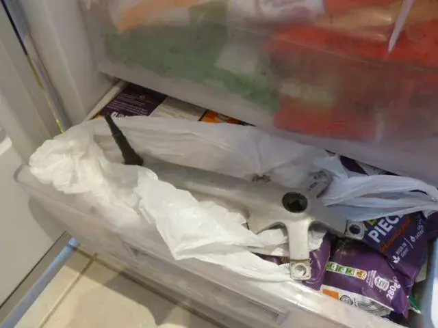

2. Freeze 'em. I wrapped each crank and pedal axle combo in a plastic bag as a nod to domestic responsibility and froze them for a few hours.

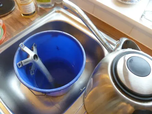

3. Boil 'em. I poured a full, just boiled kettle of water all over the axle and crank end. This went into a bucket so the crank/axle could then sit in it and get really hot. This combination provided the thermal shock and differential expansion/contraction in the alloy and steel to break the corrosive bond.

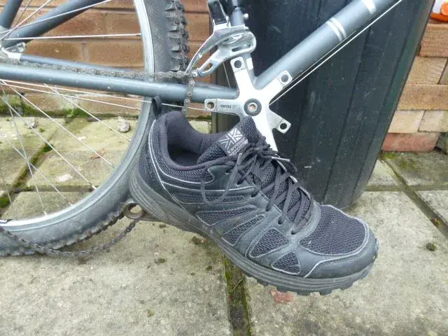

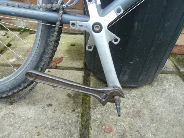

4. Mount them on a bike, any bike. This gave the leverage to work with, whilst holding the back brake on and turning the big spanner towards the back wheel. One way of turning that big spanner is stepping back on the end of the handle with your heel, whilst the ball of your foot sits on the axle. Ok, this is hard to describe but hopefully the photos will give you the idea.
You have to imagine my foot in the trainer!

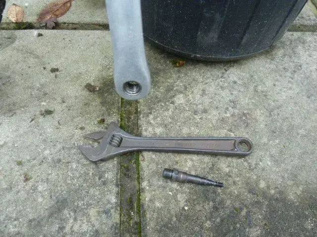

Done! Happily both cranks and pedals remain fully intact and usable :D.

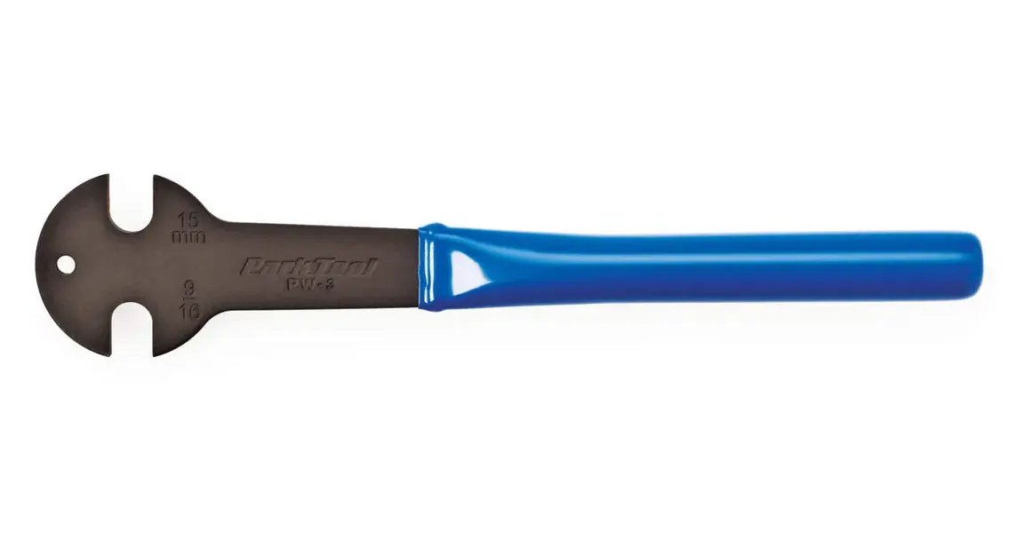

The freeze/heat cycle is a good idea. Also, getting your Special Lady Friend to buy you one of these last Xmas helps. pw pedal wrench.jpg I'm not sure if it is the offset angle of the bolt interface, or length of the arm, or just the bright blue grip, but things have seemed less stuck ever since.
Yes, a bright blue grip always helps: Park Tools are fantastic. My order from SJS Cycles is already in this year, though, so I'd better start next year's list now.

The freeze/heat cycle is a good idea. Also, getting your Special Lady Friend to buy you one of these last Xmas helps. View attachment 590456I'm not sure if it is the offset angle of the bolt interface, or length of the arm, or just the bright blue grip, but things have seemed less stuck ever since.
I use the Park PW-4. Probably the best £30 I have spent on a bike tool. Occasionally I still need to tip on some boiling water if they are really stuck but so far undefeated since buying one of these bad boys.
