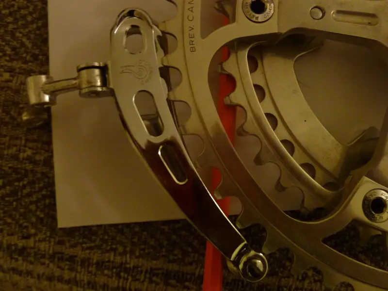

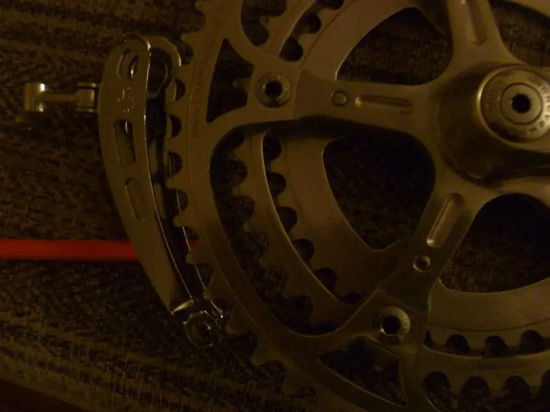

Obviously a 36 -52 should be possible but......eek ! P1060359.JPG P1060358.JPG
Sorry slightly better pic . The orange pencil is touching the top of the teeth of the inner 36 , so the chain will actually be even lower ....
