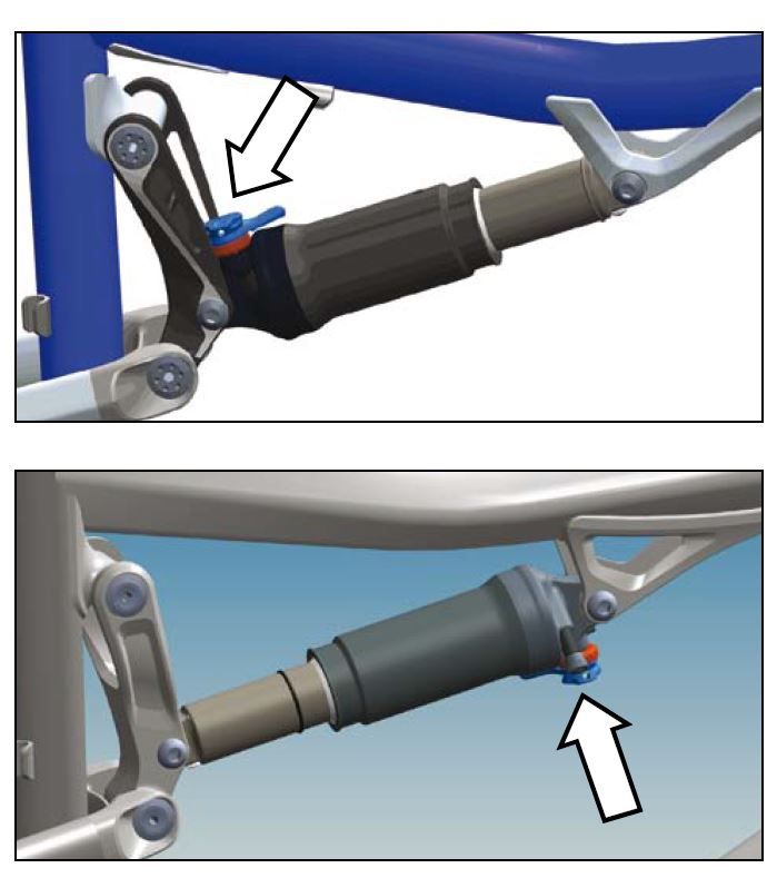

Well I can confirm changing the top suspension link does not upgrade an Rz 120 into a Rz 140. The 120 Rz frame I bought at the beginning of the year had the top link changed to the link for 140 link by the previous owner. The manitou shock that came with the frame is on its way out so I sourced a 200 x 50 shock on e-bay in great condition but it is too big.
The frame geometry of the Rz120 and Rz140 are identical but the difference in travel and shock length is created by a combination of the top link and the size of the connection point which is welded on the underside of the top tube.
You can see the difference in the two attached images from the manual. Its all obvious after the event.(Ignore the arrows they are from the manual)
Now I have a 200 x 50 fox damper to sell. The joys of second hand parts!
