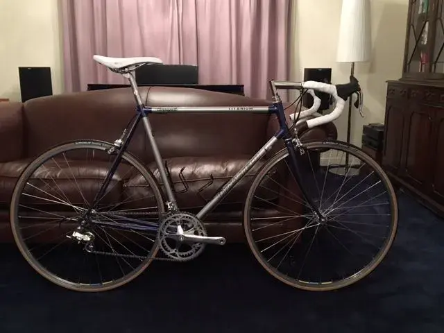

I know it is a road bike...
1993 Dyna Tech I've owned since new. Rebuilt with Campagnolo Athena.

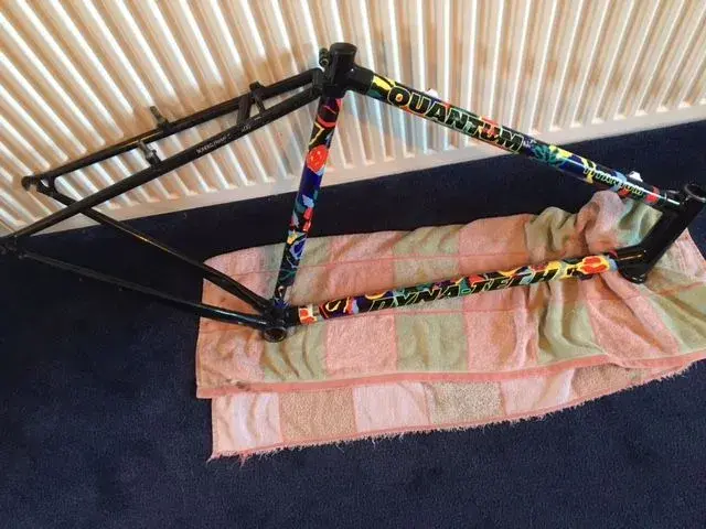

But here is my Quantum. Bought from a fellow RB'er and stripped to allow a deep clean and preservation. Break out the Autosol!
