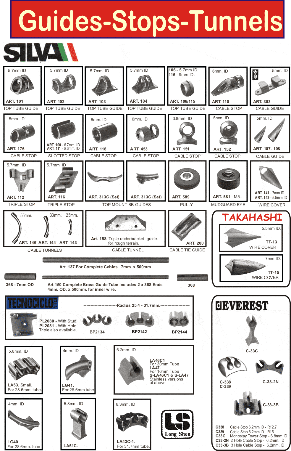

It depends on the design of the stop, here's a couple from CeeWay of differing designs. items 151 / 152 :)

I thought that the 152 didn't use a ferrule as it already acts as a cable stop and for sis cable this one usually mounted on top of the chain stay the 151 use's the 3.8mm step down usually mounted underneath the chain stay or am I confused which maybe the case.
Point taken relooking and rereading your first post{helps} you're right it looks like a normal stop but diver shaped, still stand by my shifting comment if casing is loose in the stop would say it needs a normal plain cap over the end
In this case we are dealing with an example of items 152 on the ceeway catalogue. The item 151 looks like it would take the step down-type ferrule that is supplied with the Campag kit (the narrower part being approx. 3mm across and would therefore project through the smaller hole).
I don't think the SJS ones will work as they are for 5mm cable outer and therefore immediately too big as gear cable outer is only just a tad over 4mm. Unfortunately, I only realised this after I had bought some, let me know if you want them!

The problem is that there were / are a lot of makers of diver's helmet gear cable stops and consequently, no real "standard" for internal diameter. They are normally around 4 mm / 3/16"
Additionally it might have been drilled out, or otherwise butchered at some point, either pre- or post-frame-build, for some reason. Some stops are a simple cup (but not judging by the images you provide, in your case ...)
