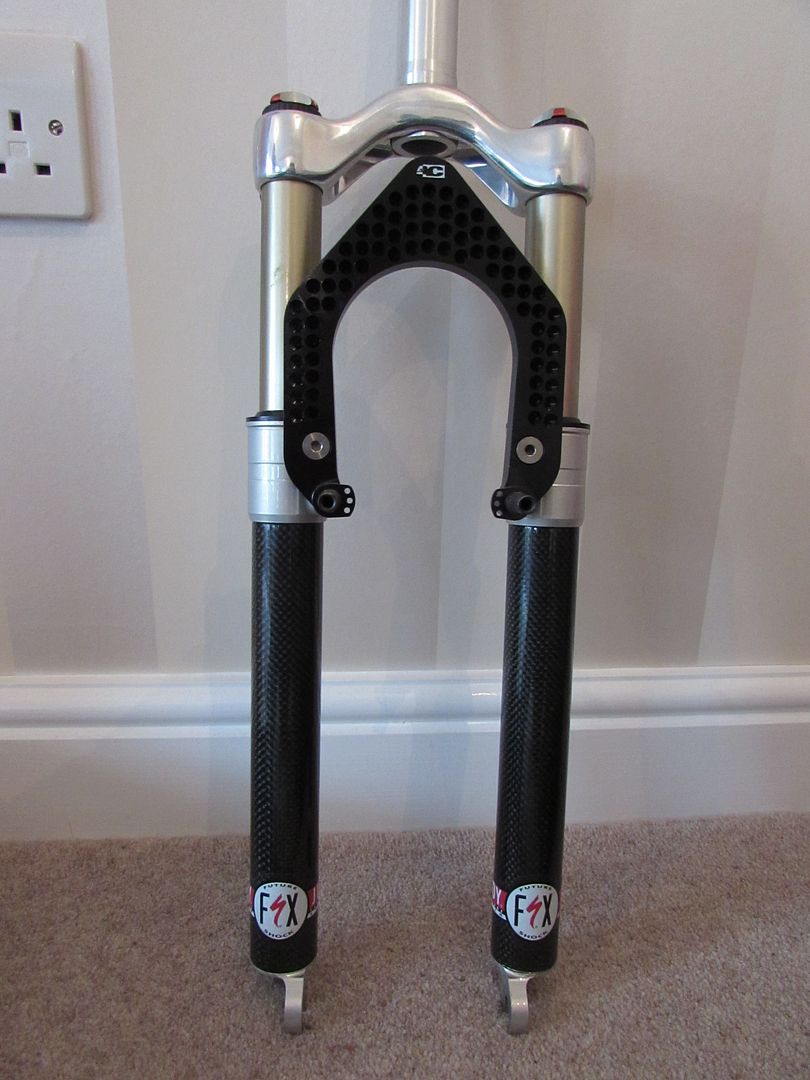

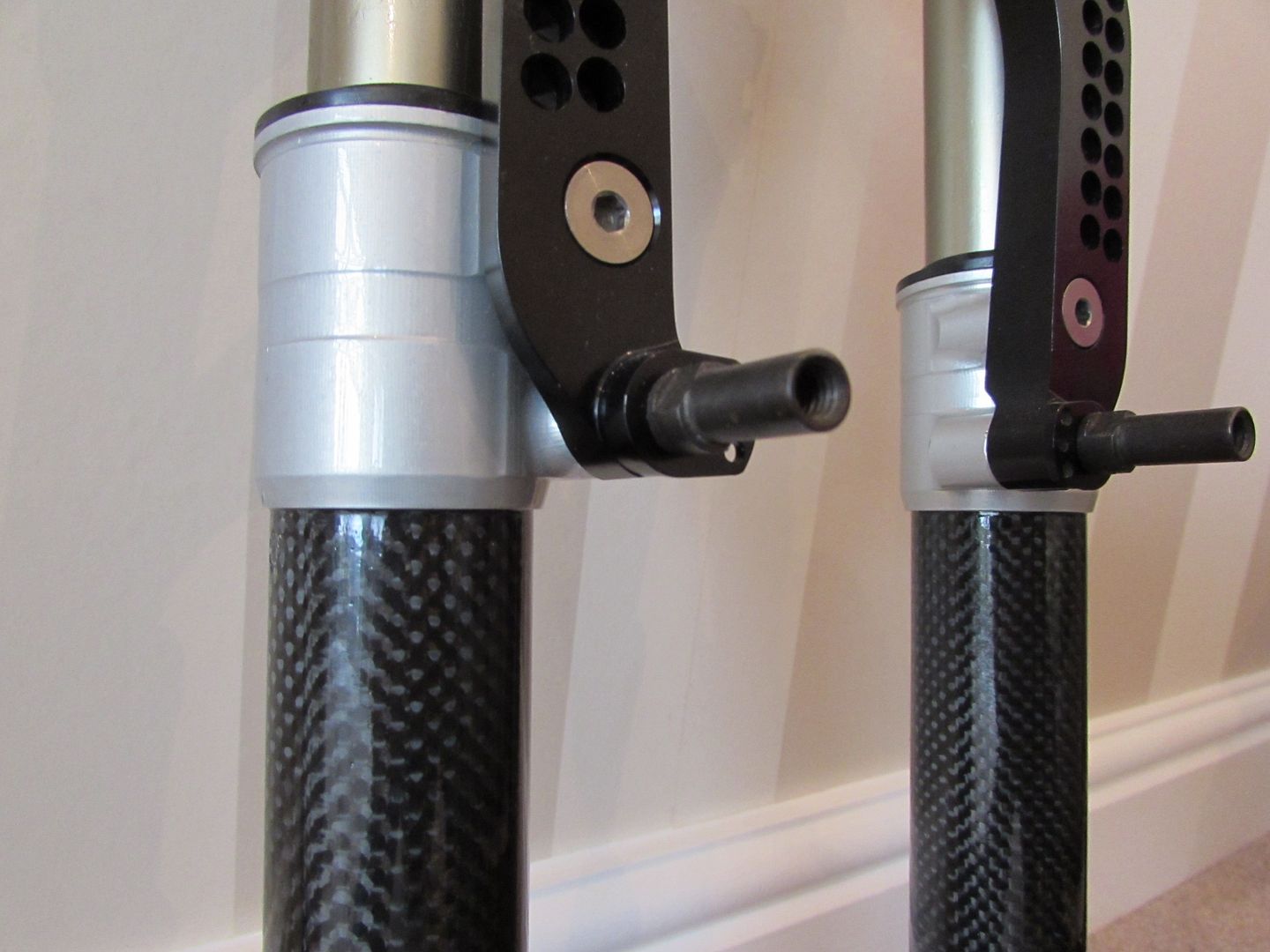

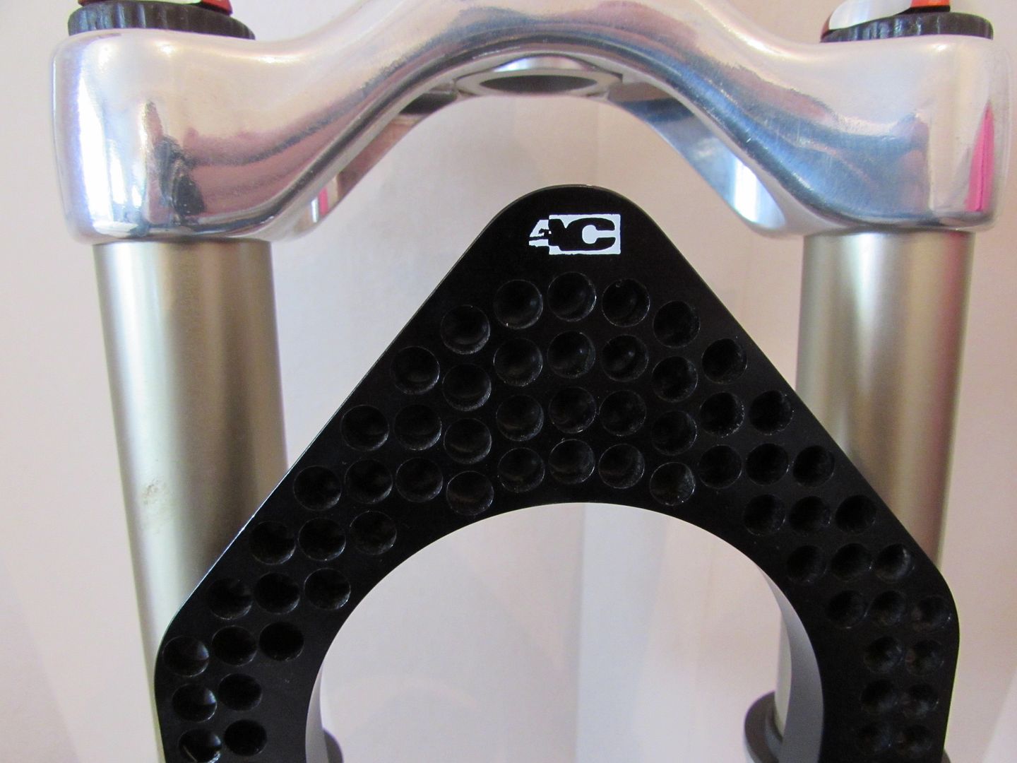

I give you my Judy FSX Carbon forks ....Almost NOS condition :cool: however Her Majesties import duty was :facepalm:
came complete with "Speed-Springs" and internals look just as good as the legs... :D

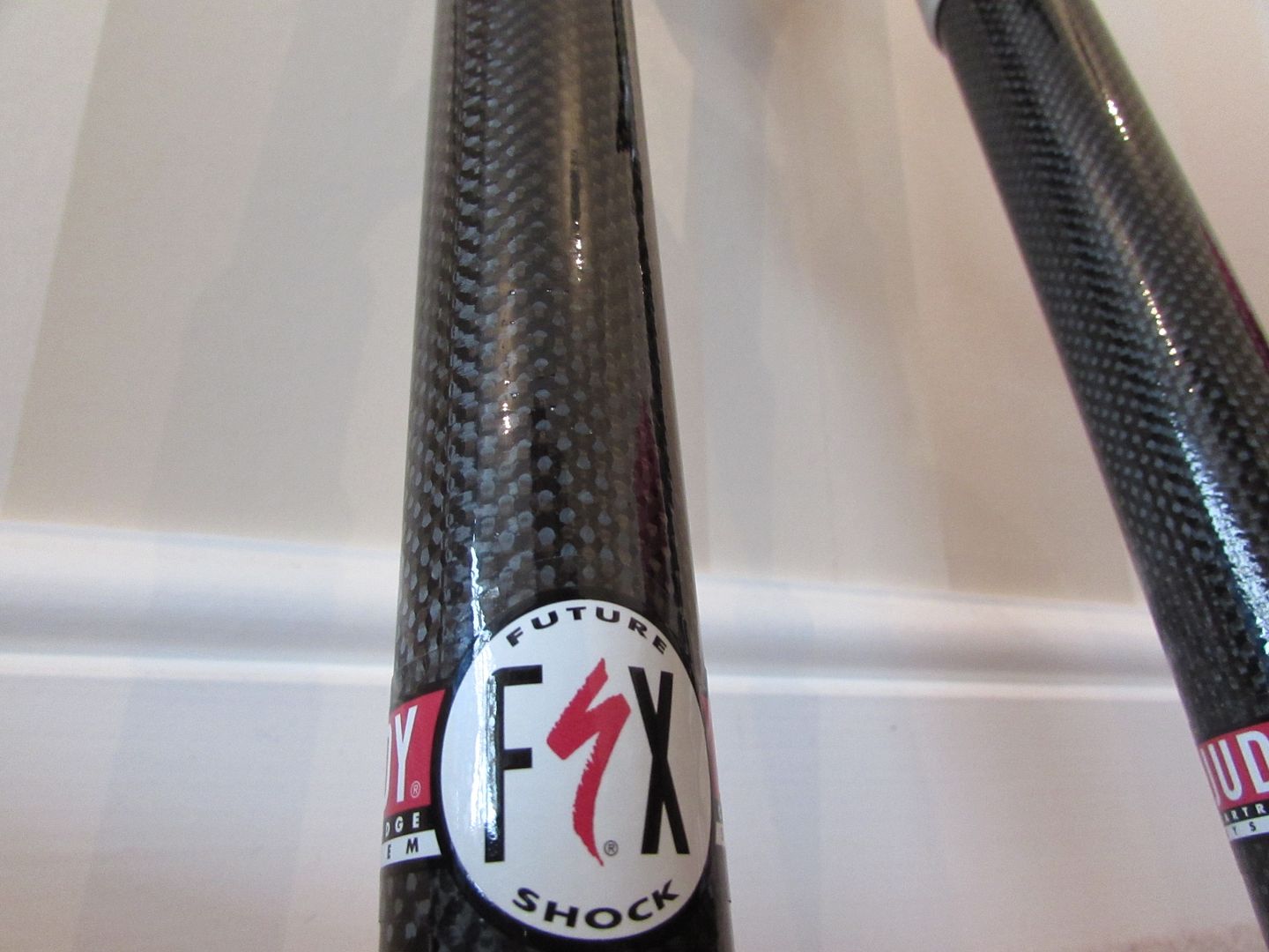

Do you have the Rock shox stickers for them? or do you need a set? I have OE reps in abundance :facepalm:
Re: Proof you can polish a Turd (Schwinn FS)
unit3":3lnscwdg said:
Nice, love a set of Judy fsx forks :cool:
cheers Unit Trois

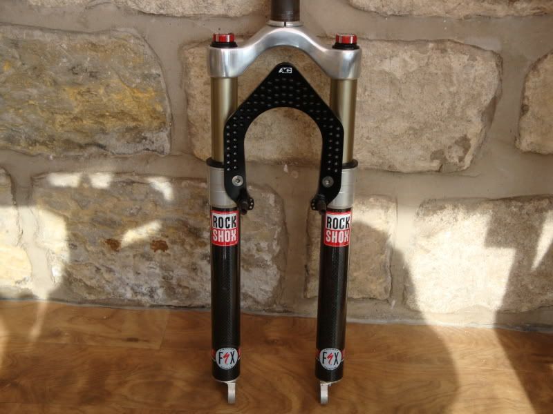

having done a bit of research they should be wearing these decals, which are a bit different to normal RS Judys.... if you have some of these I'll bite your hand off :LOL:
They came with a spare set of top caps adjusters the same as in this picture ...which I've shamelessly stolen from a post that Wold Ranger made :oops:
