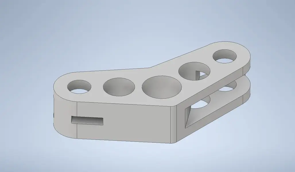

The problem: I'm missing the little lever that originally came with the frame right there:
So this will be the next part for me to make.

In terms of the rear brake thingy...
I started to draw up this not so long ago. It's not far off what the original is. I think I left room for some brass bushings to be pressed in for the main pivot. Can fire you the drawing if it's any help?
