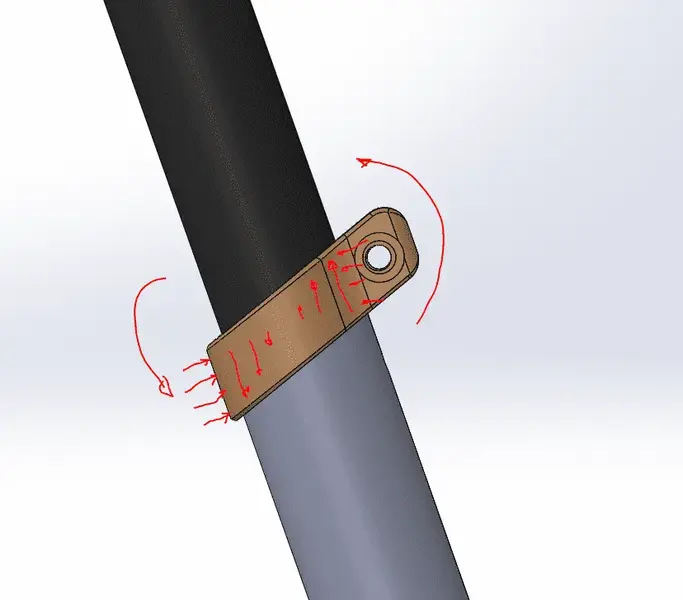

In my opinion, here pressure can not be equal in all surface because of tilted design. If it was equal, it would appear a force (torque) trying to rotate the clamp in XY plane, so I assume that most of pressure appears at both sides of the clamp, and pressure on front and rear is compensated with friction of both sides of the clamp with Seat tube to compensate the torque generated for not selfcompensated front/rear pressure.
In an ideal world, seat clamp should work like a "belt", but belt needs traction forces. Because it is tilted, then we need to create a compensation torque. The wider the cilindric area, the less pressure needed in front/rear.
