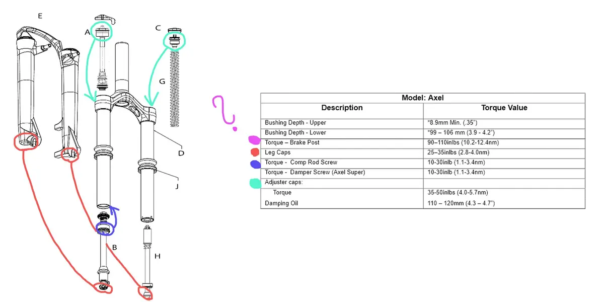

I am restoring my 2004 bike that has this Manitou Axle Elite fork on it, the fork is disassembled and everything is looking nice, I am about to mount it back together following a service manual. BUT I just can not figure out the torque specification chart, which parts are which, or which screws are which rather... So I can not fully understand what needs to be tightened to the described torque value.
Could any of you please help me with this? I am attaching a picture of what I think is correct, but correct me if I am wrong please. Also for some reason on my fork it says I have "ELITE" yet the picture in the manual seems to be axle "SUPER" and it matches what is in my fork so I might need to point out to where is the "torque - damper screw" also.
