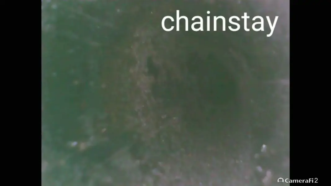

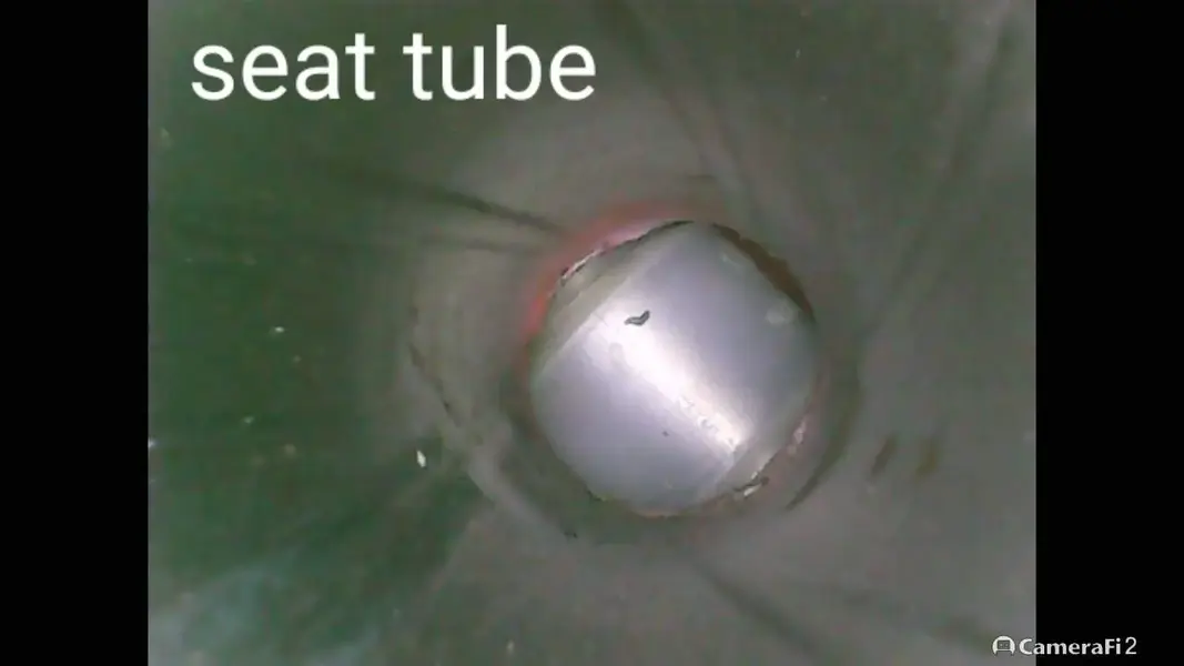

As I'm selling the bike , I was really intrigued and wanted to get the full picture, as I really though in the begining it was an SLX montello, and never actually saw an SL one. So I bought a kind of cheap endoscope, to be able to look inside the tubes, as tried before with the smartphone but did not get clear view.
Inside was quite dirty and I have big fingers, so although I was pretty sure I felt rifles on seat tube but not on main tube, I believed that's goint to be the only way , to actually see the rifling - or not to see it, that is the question!
So here results: no rifling on main tube (diagonal tube). Rifling on seat tube , and on chainstays. Here the pics.
Can we conclude that this is one of these rare SL frames with SLX seat tube and chain stays, as a predecessor of later full SLX motello frames ? Could be a rare piece between SL Treviso's and later SLX Montello's or just simply some one ordered the bike like this in the late 80's? That mix of tubing would be a reason maybe why generic columbus decal, not SL, not SLX...
