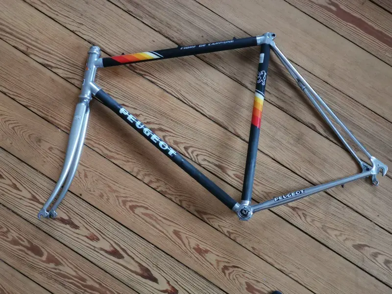

Peugeot PX10-DU
... sorry - but I didn't find an affordable original Sedis chain and since I would like to ride the bike, I installed a nearly matching chain from KMC - the tubulars are handmade French FMB Record type from Francois which I think will be acceptable since old Michelin tubulars are no longer available ...

here the outstanding full TechSpec of the build
ACTUAL
Project nameShell Peugeot MICHELIN
Project startJune 2020
Project finishedFebruary 2023
frame1985 Peugeot PY10-DU, size 56 (by VITUS)
forkVitus Dural
derailleur eyeorigin
headsetStronglight A9 25.4
stemCinelli 1R , 100 mm
handle barCinelli Champion del Monde 2nd Gen 420 mm (c-c)
bar tapeRibbon white original
housing and cablesCampagnolo, black
seat boltstandard
seat postSR Lamprade, diameter 25.0 mm
saddleSelle Italia Turbo
brake leversWeinmann Carrera #185
brake calipersWeinmann Carrera 400
shiftersSimplex Super LJ friction
bottle cageTA Specialites
bottle cage boltsstandard
front derailleurSimplex A522, Clamp 28.6 mm
cranksetStronglight 107, 170 mm
chainringsStronglight 51/42z
bottom bracketStronglight 65 BSA 1.37x24F
pedalsSpidel 700D CXC with Christophe cages and pedal strips
quick releaseMaillard
tires tubularsFMB Service Course 22.5-622
rimsMAVIC GP4 1st Gen 36 holes
hub frontMaillard 700 Professional LF
hub rearMaillard 700 Professional LF 6-speed
spokesDT SWISS Competition
freewheelMaillard Service Course 14-24z
rear derailleurSimplex LJ 4000 CP, Delrin made (173 grams)
chainKMC X8
cable guideVitus
misc.
Qui DU ... Dural and FC ...Fibre Carbone but FC has refer to the 28.6 mm diameter of all 3 main tubes small adapters between carbon tubes and lugs
