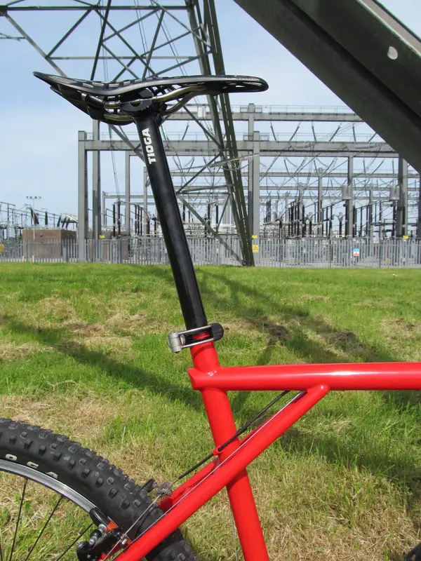

Finding a suitable seat post has been another saga. My vernier calipers had the seat tube at 26.8mm and I bought a lovely cromoly Tioga T bone from a member on here. Sadly it didn't fit, so I re-measured and went for a 26.4mm post which also didn't fit :rolleyes:
Turns out the seat tube is slightly ovalised, 26.4 in one direction, 26.8 in the other. What actually fits is 26.6, only I can't find a nice one. So for now I've fitted a £10 Ergotec, I'm gutted as the steel Tioga would have been a perfect match for the cromoly bullmoose. 😒
I have one of those Tioga posts in 26.6 mm - It was on my Ricter 8.0 that turned out to actually be a Corrado. When I switched all the parts to my actual Richter 8.0 frame I had to find a 27.0 to replace it (which took many years). I kep the 26.6 because I love those seatposts and if I got another 26.6 frame I'd be keen to use it. I'll think about whether I can part with it - let me know if you want it and I'll look for where I stashed it.
It was new when I bought it and It didnt get a lot of use.
The decals might be a little tattier now though from storage. I'll check.

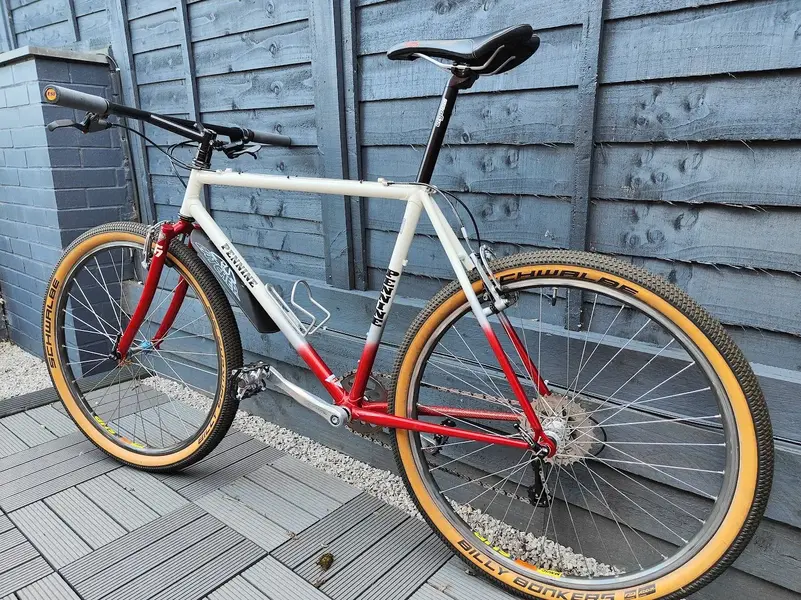

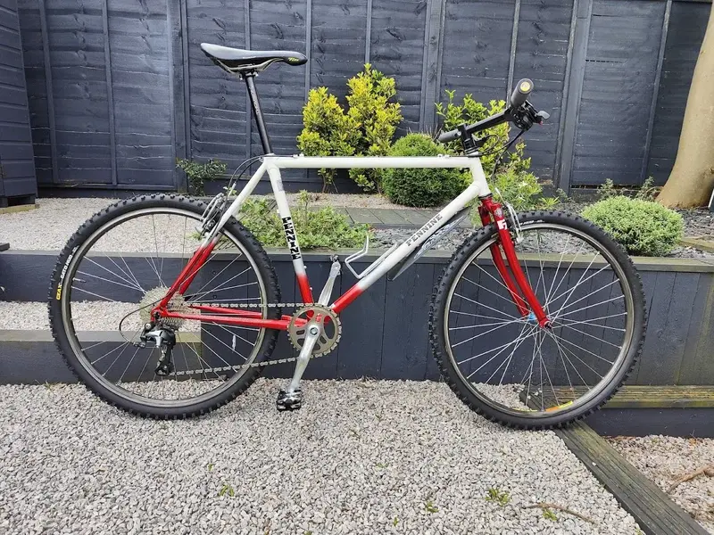

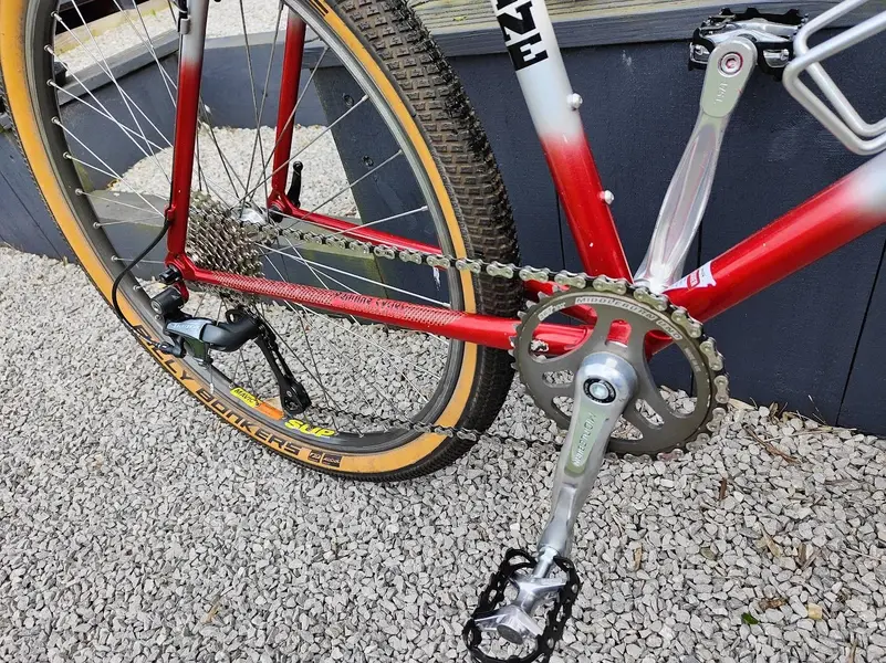

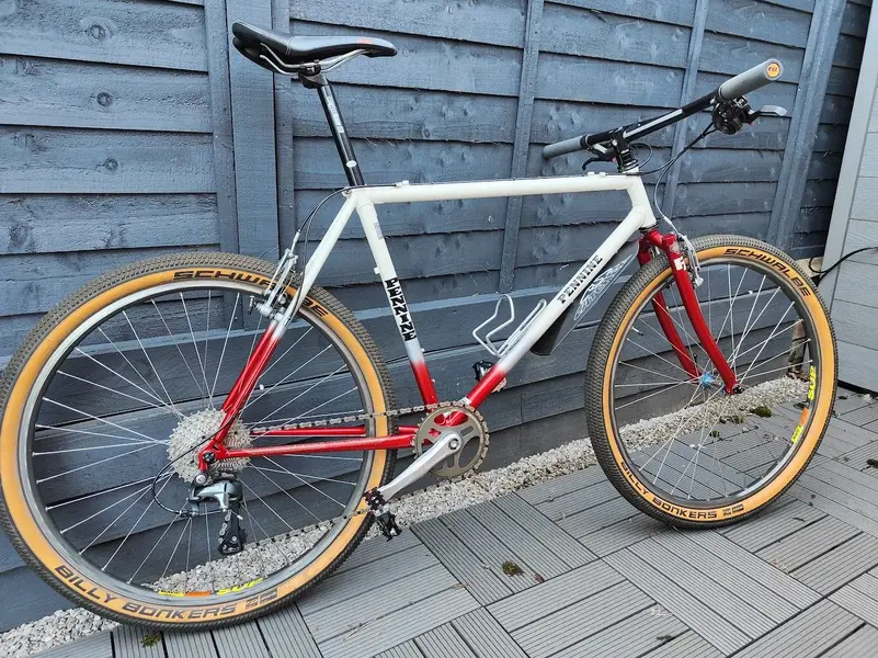

Got this together enough so I can actually ride it.
Some may question my component choices (modern parts, 1x drivetrain, tiagra road shifters and rear mech etc) but it came down to what bits I had spare and what bits I could pick up at a good price. The spec will undoubtably change, starting with the tyres and seatpost.
I wasn't sure what retro groupset to go with, which is another reason I went modern. If I'm honest I'm getting a bit bored of the same old Shimano stuff.
Anyway here's some pictures. I've only been round the block but it rides nice.

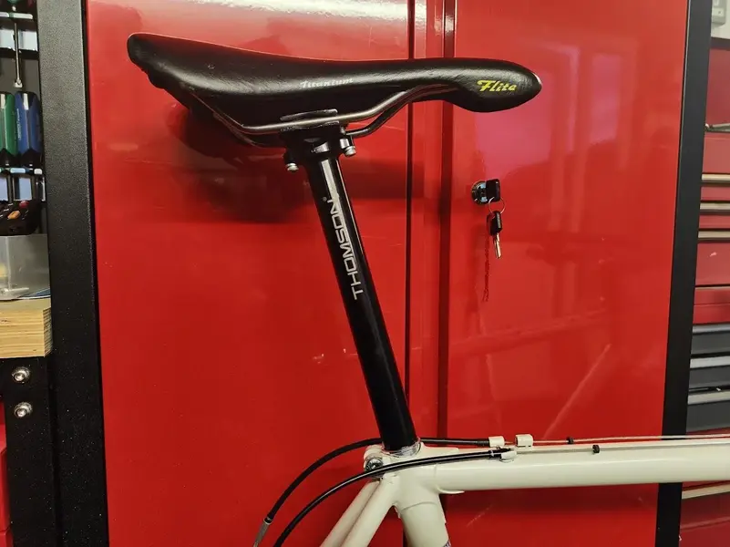

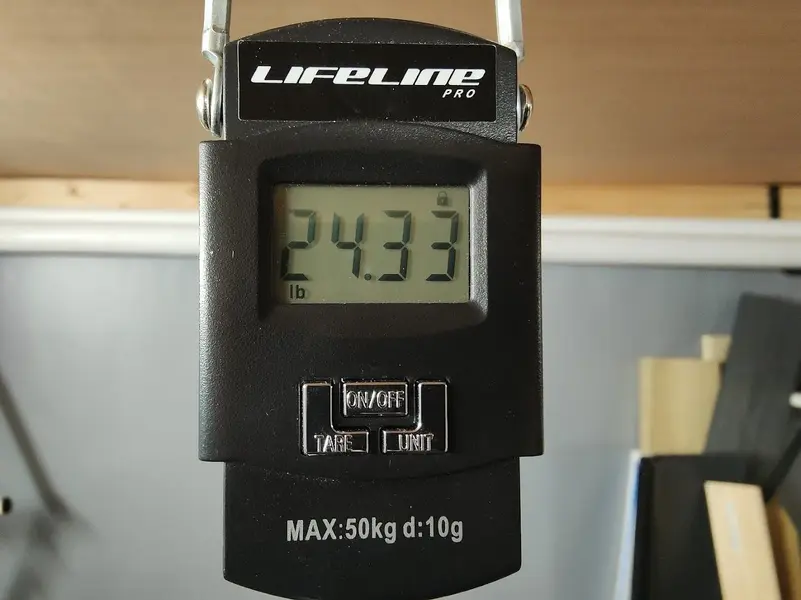

I've swapped out the saddle and post and lost a good chunk of weight in the process. The seatpost is 25.4 so I've had to use a shim.
This build is getting better and better

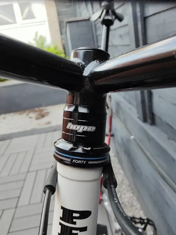

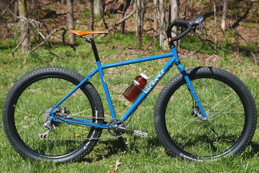

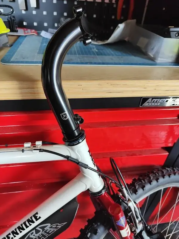

The geometry isn't a million miles away from my gravel bike. So I thought it might be a good contender for a gravel conversion. To raise the front end I bought a Velo Orange Cigne stem. It's weird, I've never had a stem that's taller than the head tube!
Looks a bit ridiculous :LOL:
I thought it looked quite cool on the velo blog though?
Thoughts? I also have a Surly corner bar so won't need to change the brakes/shifters etc.
