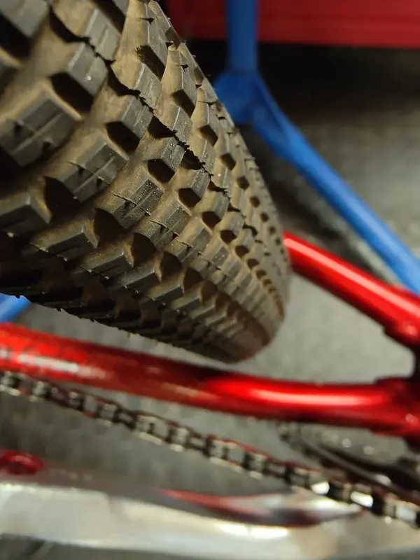

I think the tyres will need to go. They came with the wheels and I don't really like them, not a fan of the big logos. There's also a clearance issue at the rear. The Billy Bonkers measure around 2 inches wide so I think I'll need something around 1.75 inches which seriously limits my options.
I also think black tyres would suit the frame better than tan.

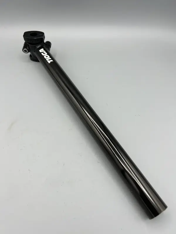

Finding a suitable seat post has been another saga. My vernier calipers had the seat tube at 26.8mm and I bought a lovely cromoly Tioga T bone from a member on here. Sadly it didn't fit, so I re-measured and went for a 26.4mm post which also didn't fit :rolleyes:
Turns out the seat tube is slightly ovalised, 26.4 in one direction, 26.8 in the other. What actually fits is 26.6, only I can't find a nice one. So for now I've fitted a £10 Ergotec, I'm gutted as the steel Tioga would have been a perfect match for the cromoly bullmoose. 😒
