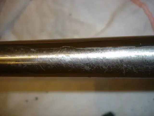

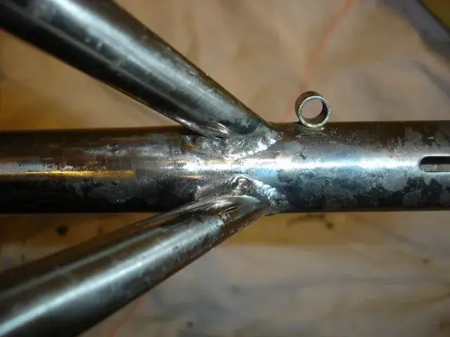

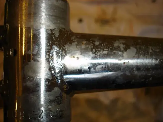

Here are some frame restoration in progress pictures ...
Using Nitromors to strip the old lacquer, then removing rust patches with a Dremel fitted with a combination of wire brushes, grinding disks and house hold scouring paste with the buffing pads. Final polish by hand using Autosol.

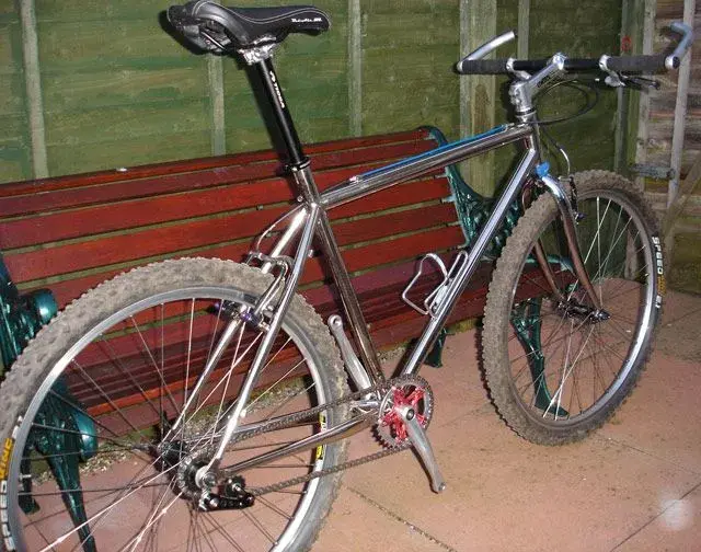

Finally finished restoring the frame, here are the results.
