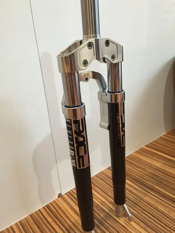

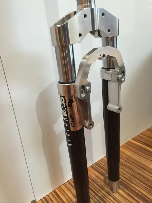

Well thanks guys for all the info and help you gave me on the servicing of my forks.
Got my new Hard elastomers and seals through the post today and set too work as soon as I received them.
My only wish was I should have got the Medium Spring rate as they are solid. Definitely won't be bottoming them out. Haha
Not too bad looking for a 24 year old fork if you ask me??
Thanks again lads,

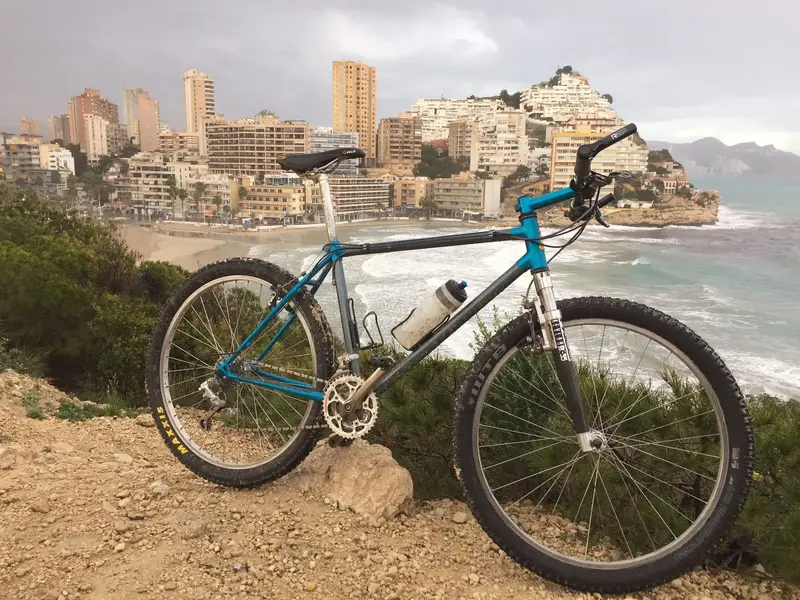

Hi dynatrax
I put the forks back onto a Raleigh Ti2000 and took it over to an apartment we rent in Spain. I usually get to ride it 2 or 3 times a year but haven’t made it out for a while. Gutted!! I thought the terrain over there would be too harsh for the forks but they are awesome!! Glad I purchased the hard elastomers. Here are a few pics.....
