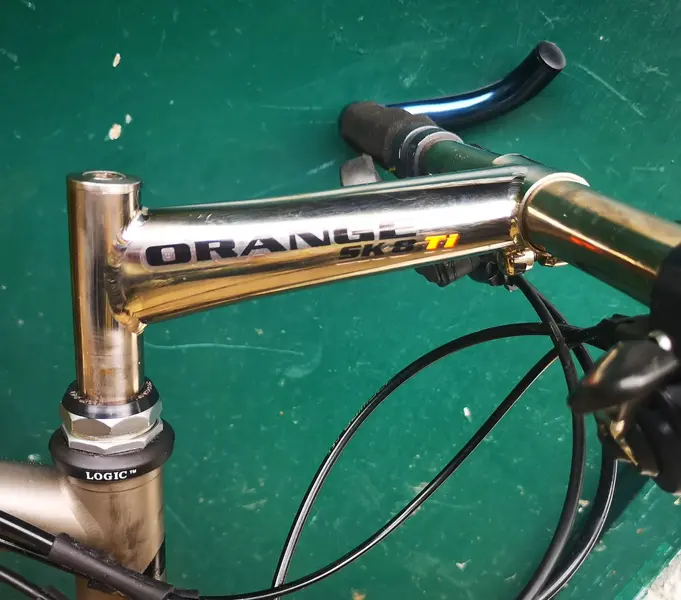

Aye - they did a good job on it at great price. Plan to be gentle with it. Been a bugger getting a correct shim for it. The one on it is a tad small for my liking & kept slipping at the max torque I was willing to apply but the next shim up won't fit. I've added a coke-can shim all the way round & it now tightens up lovely with a reasonable level of torque.
The stem seems to be a very close resemblance to the original. I have one on my t2, also one on my vitamin t, but i don't think they were around at that time. Ali stalk seemed to be the stem for the early ti's, but i could'nt find one in a 1/1/8th.
Did the ti stem come with a small ti cap to protect the top bolt?
Aye - cap & bolt also Ti.

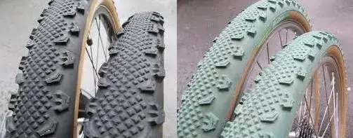

Also put on some smoother tyres as this is the bike I'll be using if riding on lanes & roads.
I shouldn't be telling you this as i'm after another pair but i think the michelin sprint is a great tyre to have for lanes and roads, it sets off the ti fame off to a T (excuse the pun) and it has very little rolling resistance, plus its RETRO!
They also did them in hens tooth black with gumwalls. :cool: :cool:

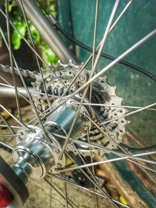

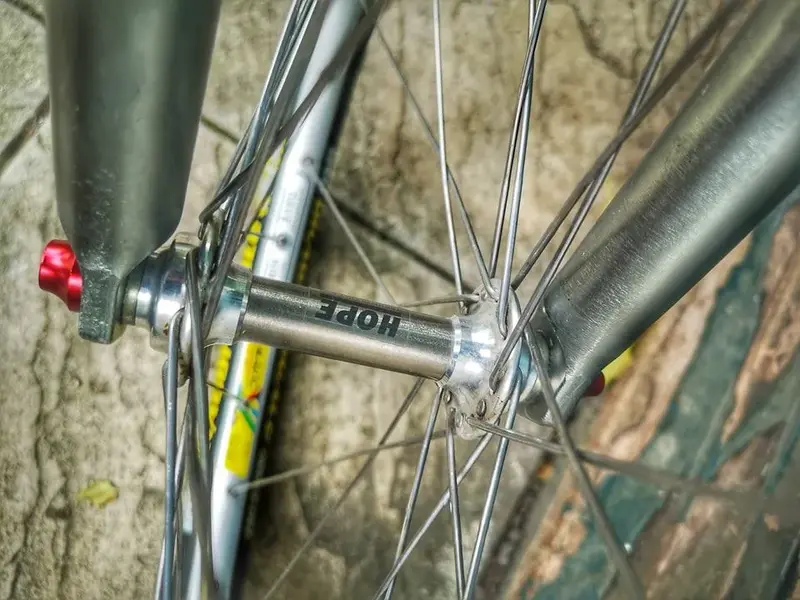

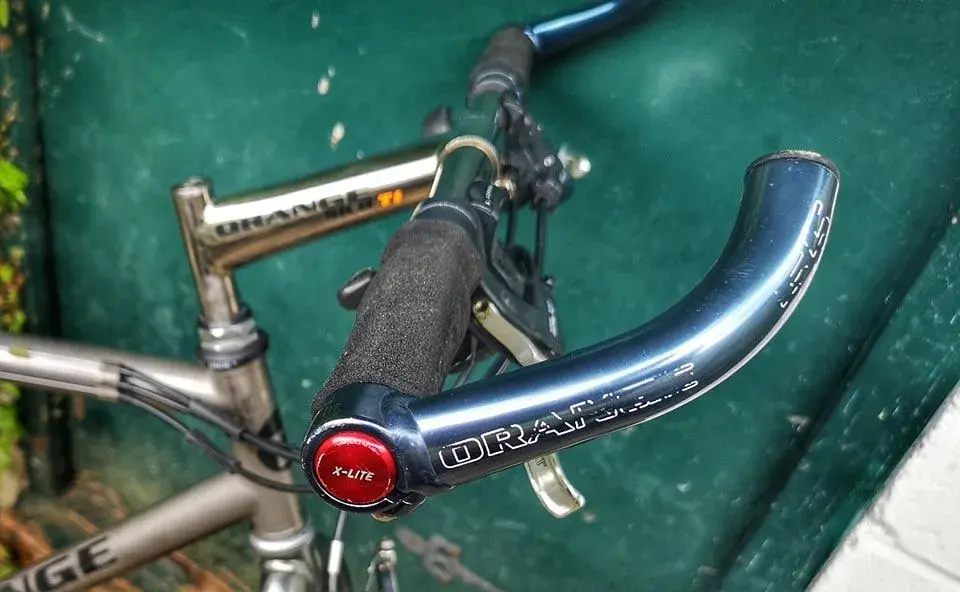

After the weld that was on it when I got it cracked again, it has been rewelded by my local welder, He only welds Ti & wasn't too complimentary of the previous weld. As it had to be stripped & rebuilt I took the opportunity for a few changes - ditched the sunset/XT wheels's in favour of Hinde built Mavic 231's on Hope Ti hubs with much lighter IRC Dragon Scale tyres. Also swapped out the Onza bar-ends for the much lighter gunsmoke Orange 55's. The Orange SK8 Ti decal on the stem is still a deceit but now accurate - it is a ti stem but not the Orange one. Also swapped out the cheap modern cassette for a XT M737 one. Weight down to 19.8lb.

Stem: Titanium (no name) with Orange Ti decal

Barends: Orange 55

Cassette: Shimano 8 speed 11-30T XT M737
Chain: KMC
Cranks/Chainrings: Middleburn RC2 46/36/24
Bottom Bracket: UN300
Pedals: Tioga Surefoot IV
Hub Skewers: Halo lock-ons
Rims: Mavic M231
Hubs: Hope Ti Glide & Ti Light
