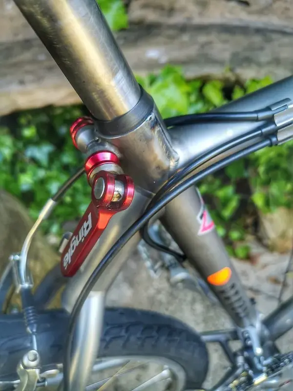

I'll let someone else answer that. I've got a 28.2mm shim in there. The seat tube was repaired & has a tiny 'step' in the circumference at the weld. I couldn't get the old shim in with the seat post after the repair so went a touch smaller & padded out the step with a coke can shim.

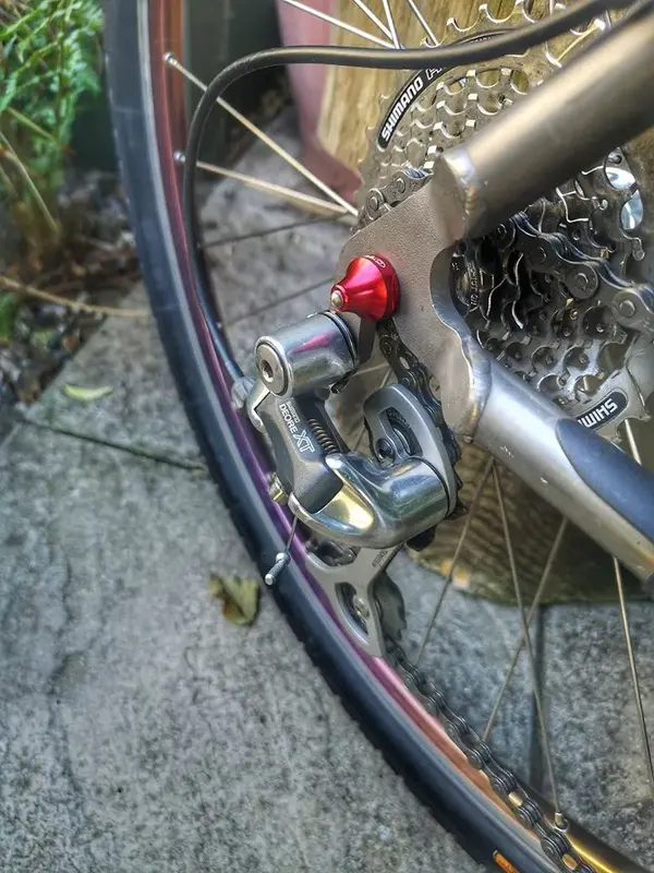

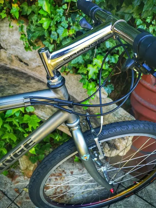

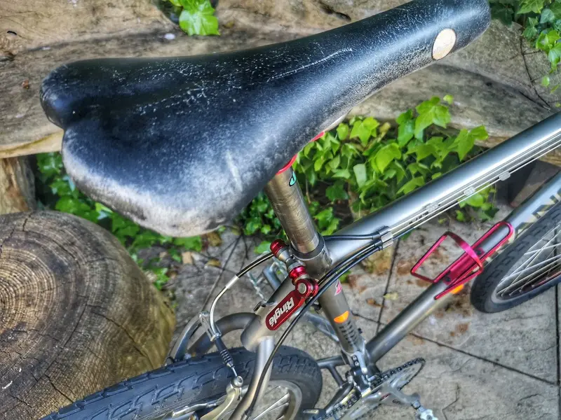

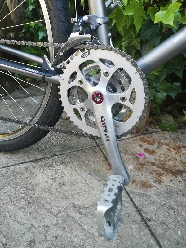

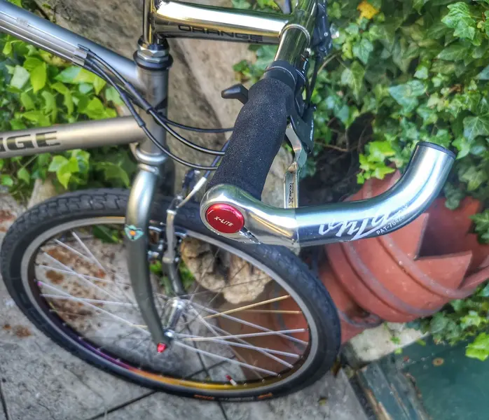

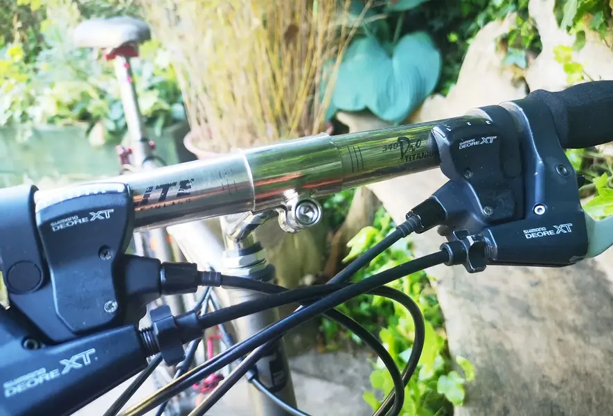

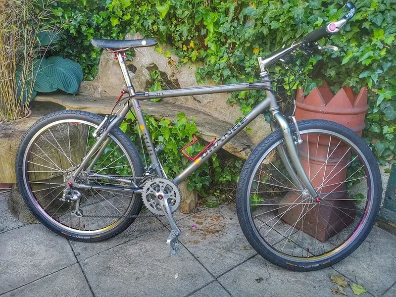

Given the bike a bit of a makeover that's toned it down & lightened it up. Some of the old parts on it are best suited to other builds. Got the Orange saddle karma'd from boy"O"boy so well chuffed. Added Ti stem, bars & seatpost. The stem is unbranded but now wears an Orange Ti decal as a mild deceit. Also 'upgraded' to V-brakes & replaced the headset which was borderline when I got it. Dropped 2.7lb off the weight. Also put on some smoother tyres as this is the bike I'll be using if riding on lanes & roads. I'm planning Hope Ti hubs at some point & maybe an XT cassette.
Frame: 19" Frame number : A312xxxxx (Dec 1993 Build)
Fork: Orange F9
Headset: Ritchey Logic
Stem: Titanium (no name) with Orange Ti decal
Handlebar: X-Lite Titanium
Grips: Ritchey
Barends: Onza
Brakes: Shimano XT M739
Brake Levers: Shimano XT M739
Shifters: Shimano M740
Front Derailleur: Shimano M737
Rear Derailleur: Shimano M739
Cassette: Shimano 8 speed 11-34T HG1
Chain: KMC
Cranks/Chainrings: Girvin (Sugino)
Bottom Bracket: Unknown (new)
Pedals: VP Components
Hub Skewers: Halo lock-ons
Rims: Mavic 217 SUP Sunset
Hubs: Shimano XT737
Saddle: Orange ti-railed
Seatpost: USE Titanium
Seatpost Clamp Bolt: Ringle
Bottle Cage: Tranz
Weight: lb 21.8lbs
I quite like the fix.
By the way nice saddle! I have a penchant for ti on my derriere.
