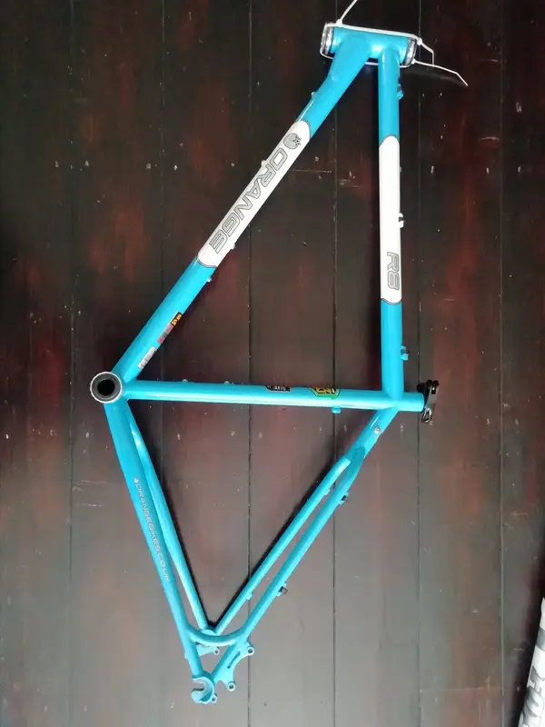

After a lot of indecision, this came up and I knew it was the one for me:
One I'd completely forgotten about. I now remember thinking it was great when it came out, but that the price was too high, so it was quickly dismissed.
Seems like they were priced too high as this frame came from the original owner with a purchase receipt for showing he paid around half price for it.

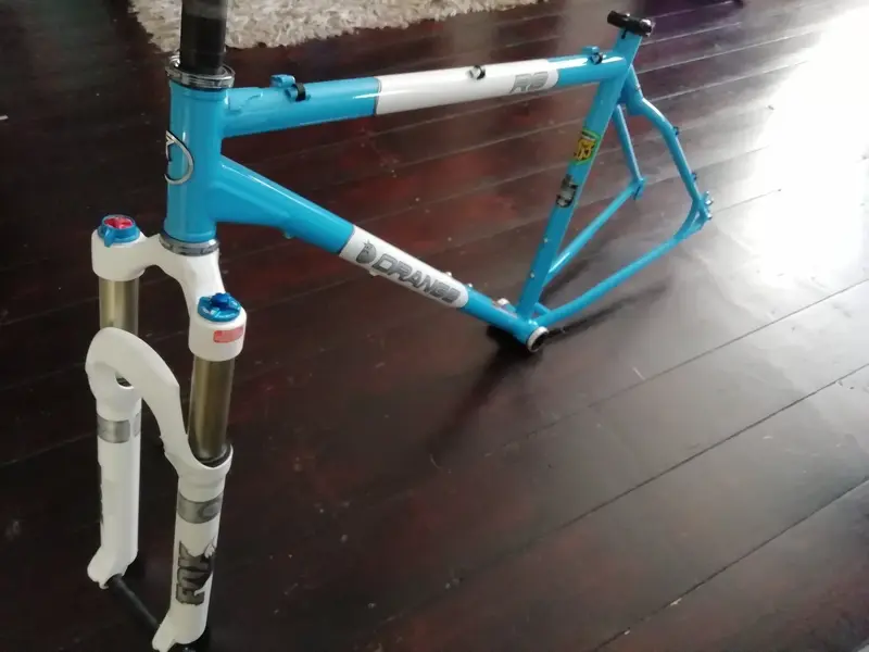

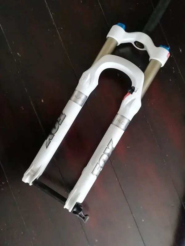

I acquired a lovely set of Fox Forks a while ago which I will be using. My previous Fox Forks served me well before so I don't feel the need to look anywhere else.
These are the TALAS version which I'm not that bothered about. I was never one to fiddle with things on the go. Just a 100 or 120 RL would have done, but these are in such great condition and in white too which will suit the frame much better than black ones. The frame is not rated for 140, so I'll try the 120 and 100 and probably just pick one and leave it there.

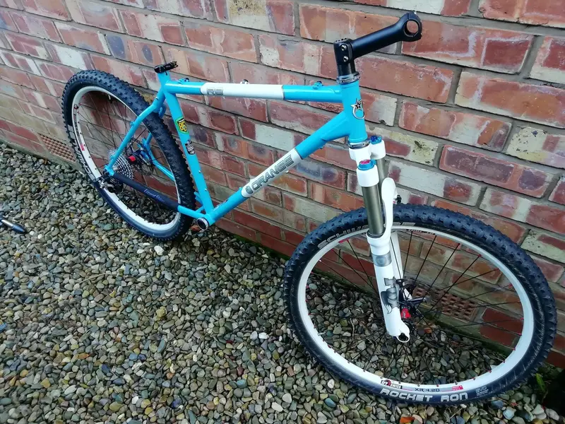

A quick try with the frame:
Would rather the headset was black, but the grey will have to stay as I've not got the tools to install another.
I have a few sets of wheels, but only one with a 15mm front axle. A DT Swiss set currently buried at the back of the shed. They are also white, so should look ok (better if they didn't have red on them).

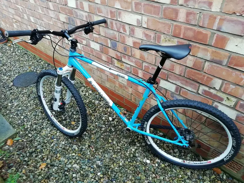

After a busy few weeks, I finally managed to get a bit more done.
Wheels dug out from the back of the shed and fitted with RT97 rotors (was trying to avoid XTR, but I really like these) and a brand new XT M770 Cassette. The rapid rise rear derailleur has also been fitted. It has a few scratches, but hasn't actually been used much.
The bars, stem (stem in photo is temporary to stop forks falling off) and Seatpost were delivered today. I chose to buy new ones rather than used and went for Race Face Ride all round. I originally got a bit carried away and ordered the Turbine, but then realised that I probably wouldn't notice the difference and I'd be better off losing a few hundred grams myself than spending the extra on some lightweight components.
Hope to have more done in the coming days.

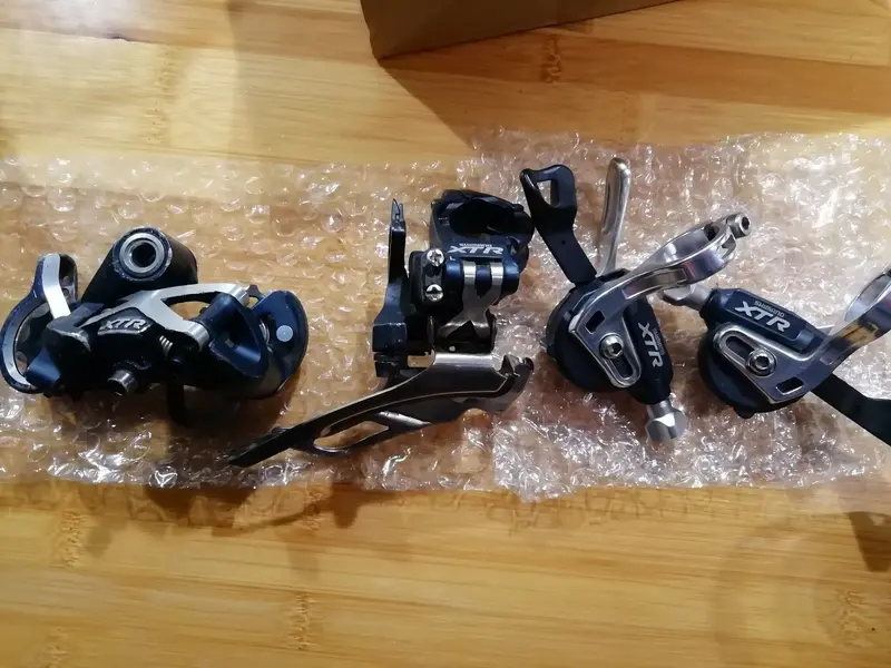

After saying I was trying to avoid XTR, these came up for sale on here and I do like the m970 shifters. IMG_20240113_222328.jpg
But, on the other hand, I also want to give the XT shifter levers a go even though there is a strong possibility I'll not get on with them like pretty much everyone else who has tried them. Maybe just one ride, then if I'm not won over I'll get the XTR put on along with some XT m985 brakes. The 25th will be bike finishing day so I have until then to decide.
