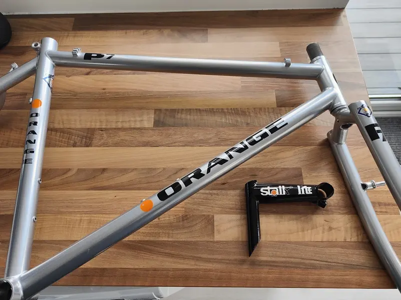

I have a '94 Orange P7 frame that the nickel is peeling from, so I'm planning on getting it painted in a new colour. How is best to remove the nickel coating? One place has suggested an acid dip, another has suggested shot blasting? Are they both suitable? Any help appreciated. Cheers, Rob

Thank you for that - I am talking to two local powder coating places, but had two options - one suggests the acid dip would work, the other sand blasting - hence checking on here as I wasn't sure which would work! Google hasn't clarified for me so far 🥲

I did ask about reverse plating it, but they seem reasonably limited in what they do - both businesses. I spoke to another guy, who's a good hour away, and they reeled off a list of stages, but it's double the price, plus time/petrol. As I don't know much about it, I had to reach out in here for a bit of comfort!

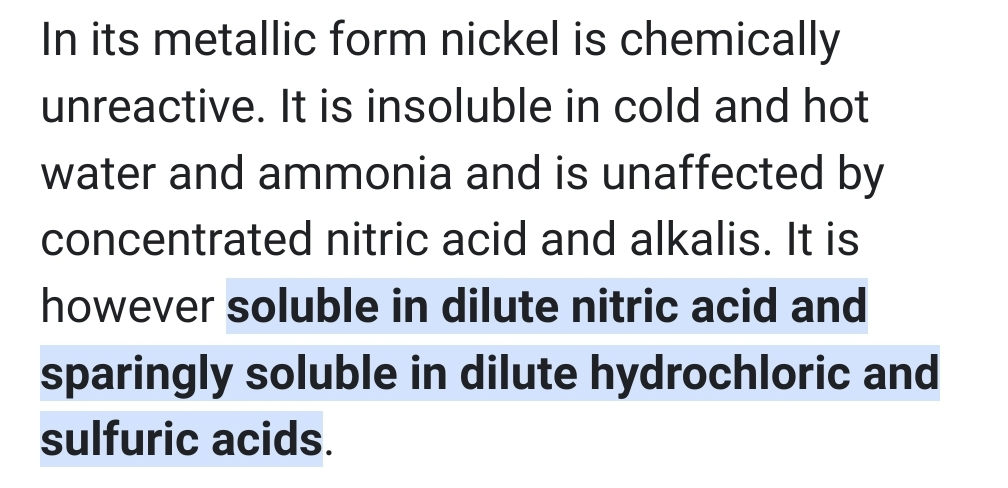

Nickel and steel are similar in hardness, and in fact the plated deposit could be tougher than the underlying steel (tange prestige?)
Chemical:
Looks challenging🤔
