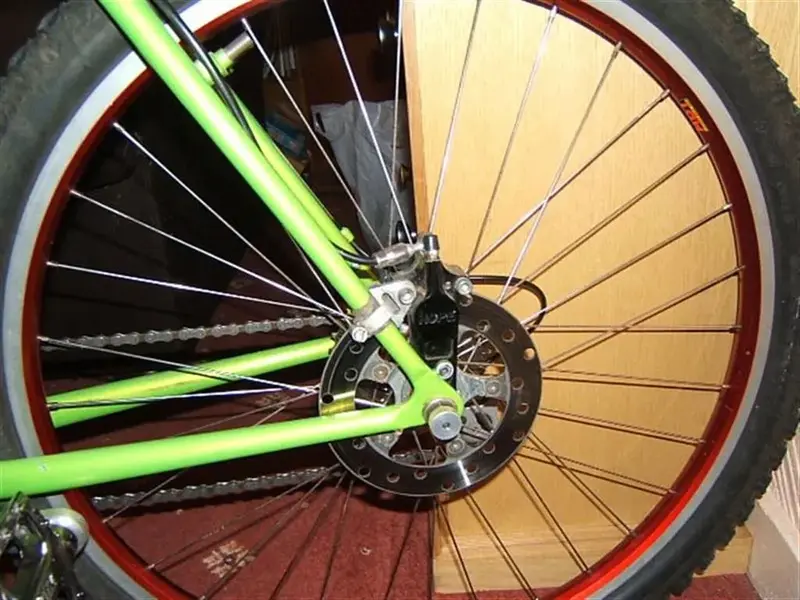

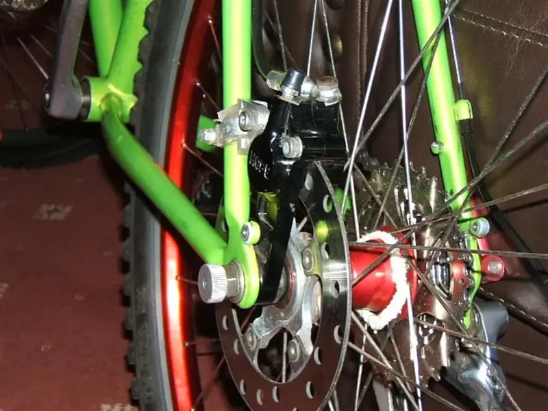

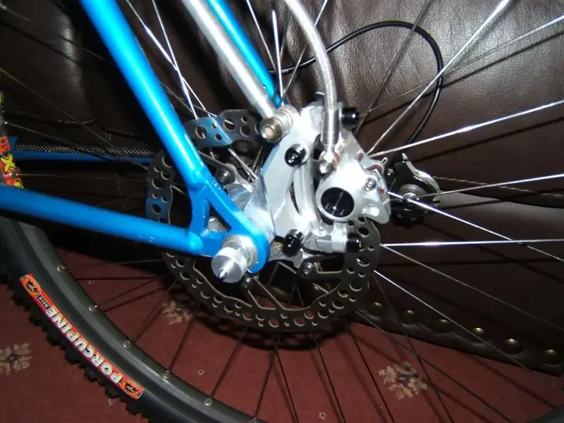

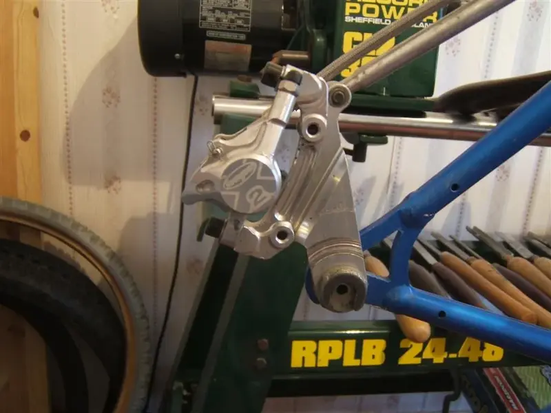

Rear disc
Again ,not a problem.There are a few bolt on systems,namely Hope's no2 caliper,A2Z,Critical Racing and i think others.
A2Z,Critical Racing etc bolt an international standard[I.S.] mount onto the frame at the non drive side dropout.
The Hope brake system also bolts on in the same place but incorporates a caliper as well.
I think the member Big.Eck has a couple of no2's available[he has every part hope ever produced :LOL:]
Here's a couple of pics of the Hope No2 brake fitted to my '99 Clockwork[slime green] and an I.S. mount type fitted to my '98 Raleigh torus[light blue].
