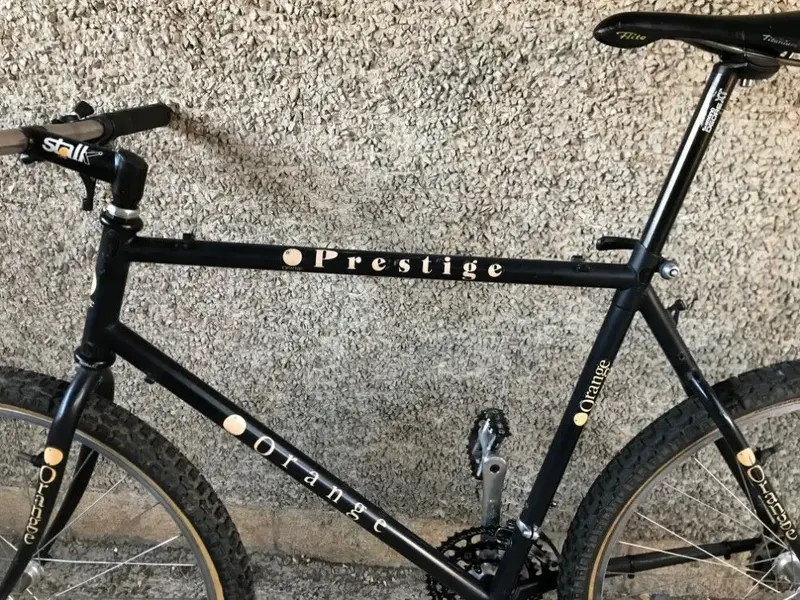

Both sets of decals are correct. The standard decals from 89-91 were the version Gil has but the wider spacing with larger font did also pop up although usually in orange and on the early Prestige. The style changed to the version seen on your bike in 92 (and is my favourite). Gil also has the 92 style.

My frame was new old stock direct from Orange, they literally found it in a pile of boxed stuff that hadnt been looked at for 30 years. I had a really interesting chat with them and they felt it was one of their very earliest frames and as the slightly ropey paint finish confirms, it was most likely a proto and not origionally intended to be sold. This probably explains the decals.
I had never seen decals like it either but given its direct from them Im not going to over worry it....its both origional and "origional" as a possible one off so perfect for my collection.
I bought a set like Gil shows (from Gil) for the yellow fade I have which I bought from orange at the same time (a few of the decals had peeled) which is the same sort of year, they are great quality and identical to what were on it so I would suggest Gils are correct and my orange one was possibly a one off.
Long story but I was lucky enough to visit where they assembled the bikes in about 1994 when they moved warehouses in Halifax .... I remember they had loads of frames hung up from the last few years including a lovely Formula which had been in one of the magazines for a test years earlier. I was picking up a replacement frame after bending a clockwork and they asked me what decals I wanted in case I wanted to try to match my damaged frame ...they seemed to have quite a few options but Ive no idea now what they all were. From photos I have of me riding I obviously went for something like the ones Gil is showing.
The 94 trip I will never forget as looking round the place was amazing, my frame was literally just out the paint oven and they told me to wait a few days before putting the decals on.....plus I seemed to buy a P7 frame too (black with nlock orange decals) whilst I was there which I struggled to explain when I got home.
Yeah, you used to be able to buy old decals direct from Orange. I remember that from when I did work experience at Airevalley Cycles in Keighley, working alongside Chris Akrigg. :cool:
The orange bike is early but not a one off. Seen a few in that colour and with those decals come up over the years, one not so long ago.
Well brock, that sorts it then. Thanks for clearing it up. However, I'm not too sure if I like the spaced out "Orange" on the down tube, as it doesn't match the rest of "Orange" logos on the bike. But I do like the spaced out Clockwork on the top tube. I've asked Gil if it's possible to do a set of decals with both versions of the "Orange" for the down tube, one set spaced out and the other normal, whilst I try and make my mind up.
