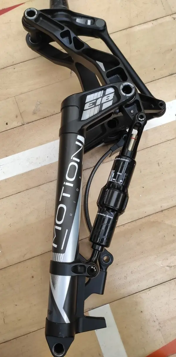

Is that some sort of anti-dive arrangement there?
Looks like the lower section pivots forward as the fork compresses, and braking forces extend the fork. 🤔

"When a grainy photo of a linkage fork appeared on Push Industries' Instagram account a few weeks ago, it caused a bit of a buzz around the industry, in part because the news of Specialized's acquisition of Trust's linkage fork patent came out just a few days prior. There have always been those homegrown trade show contraptions or student engineering projects that appeared on the slopes of Whistler Bike Park, but for these names with a lot of clout in the bicycle biz, it made us think. With their ability to dictate axle paths and anti-rise characteristics, are linkage forks the future of mountain bike suspension technology?
Push Industries has been well known for their tuning and aftermarket kits for some time, but when they introduced their ElevenSix shock, it raised the question - what comes next? Building a rear shock is easy. Simply throw a block of aluminum into the CNC machine, pop in your favorite shim stack, slide on a suitable spring, and voila. Sure, there's A LOT more to it than that, but a fork on the other hand takes a large investment magnesium cast, that is, if you build a traditional fork with one-piece lowers.
It might look like a desktop daydream, but Push actually began prototyping the fork you see above in late 2015. The inverted, dual-crown chassis is also linkage driven. Based on the Earle's Fork patent, used on BMW motorcycles from 1955 to 1969, the leading link design features a link arm main pivot that rides on the lower leg while the dropout is attached separately. Behind the stanchions is not a fender, but another arm bridging the link to the upper tubes.
If you can imagine the front axle moving from the 5-o'clock position up to 3-o'clock, then you understand one concept of the Earles fork: a lengthening wheelbase. The prototype also tested anti-rise levels that are induced by the brake forces, but unlike traditional forks, it can cause the front end to rise under hard braking. USD forks are susceptible to lateral deflection, but the Earles concept helps to stiffen up the steering.
