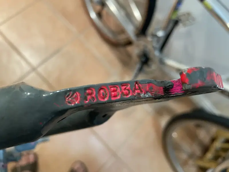

I think Klein numbers were hexadecimal into the 90ies, my frame numbers at least do not make any sense except the first letter (although even that is non- consistent). Would agree this is post `88 because of the missing U brake.
I'm unsure how useful the serial number is, here's mine, I'm reasonably confident mines a 91':
Another method I think is helpful in identifying the year is measuring the frame. 1990 20" Pinnacles have a 22" effective (virtual horizontal line) c-c top tube length and 11.7" bottom bracket height, 1991 19" Pinnacles have a longer 22.5" effective c-c top tube length (20" frames have an even longer top tube) and lower 11.5" bottom bracket height.
