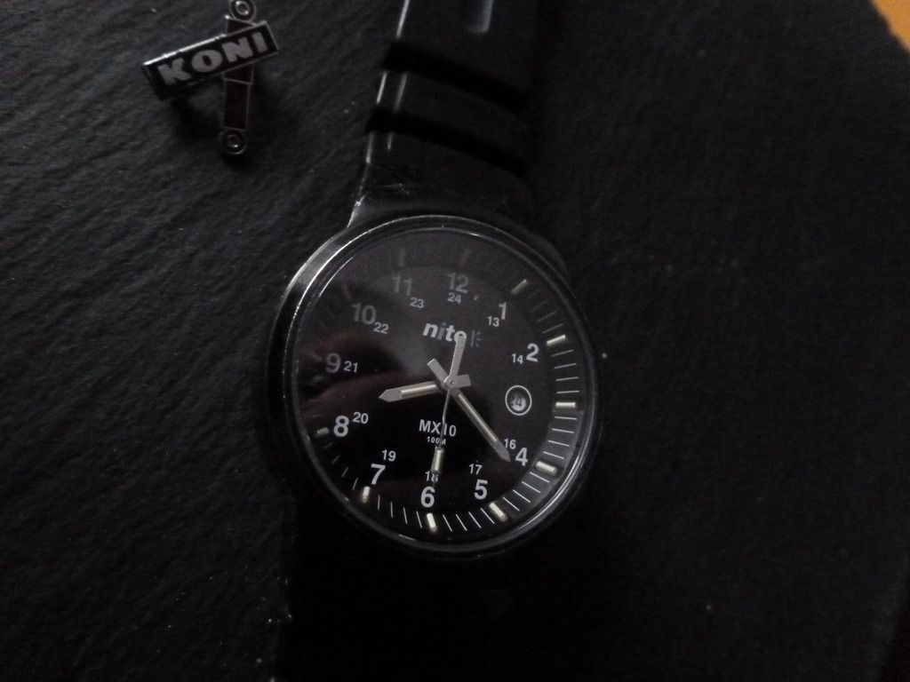

As the 3rd year of ownership approached the watch started losing 6 or 7 minutes a day, I thought it was the battery reaching the end of its life (they should last 3 to 4 years) so I stuck it in for a service with Nite.
I got a new battery, seal, strap + pins and pressure tested, when it came back it was still losing 6 or 7 minutes a day. So off for a second time to get checked, they said it didn't lose a second so it came back to me. Now its sitting here next to me showing 2hrs & 25 mins slow over the space of a few weeks. As I picked it up just now to check how slow it was the second hand had stopped till I shook it. So I'm the owner of a none functioning table ornament :?
I may add that because 'they' say there's nothing wrong with the watch its not cost Nite one single penny but has cost me probably into three figures now for what should have been a simple service.
They can easily check the timing of your watch Rob, try and find a decent watch repairer if you can, they are few and far between in my experience though.

Given that the Nite watches use an "off the shelf" movement, it shouldn't be too difficult to sort it out.
I got a new battery, seal, strap + pins and pressure tested, when it came back it was still losing 6 or 7 minutes a day. So off for a second time to get checked, they said it didn't lose a second so it came back to me. Now its sitting here next to me showing 3hrs & 25 mins slow over the space of a few weeks. As I picked it up just now to check how slow it was the second hand had stopped till I shook it. So I'm the owner of a none functioning table ornament :?
It could be dirt in the movement, a lack of oil or maybe old oil that's gummed up but unlikely considering how old it is. A strip down and service will get it back to full health but with quartz movements its usually cheaper to fit a new movement. The problem with this one is that the wheels that the hands are mounted on will be longer than normal as the hands are so much fatter with the tubes in them, so a service may be the only option.

Now its sitting here next to me showing 3hrs & 25mins slow over the space of a few weeks.
Its now reading 3hrs & 31mins since Sat May 28, 2016 11:42 pm (yesterday) that'll be 6 or 7 mins by that time tonight. Yes NITE 'your' right it doesn't lose a second its minutes :x
