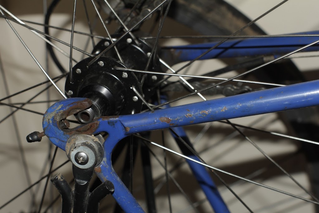

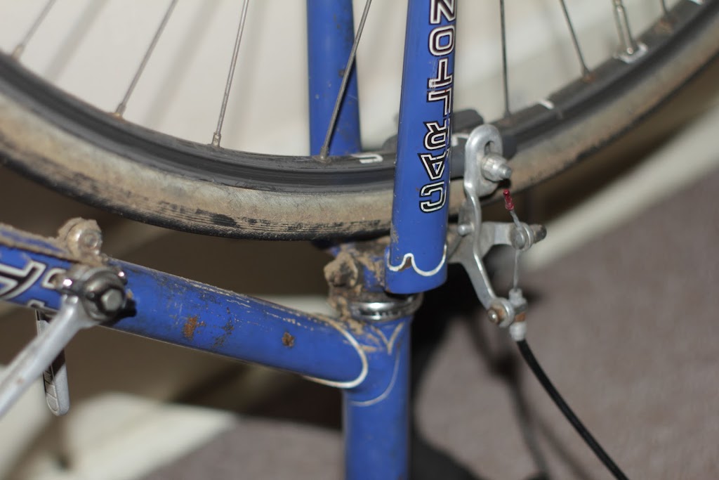

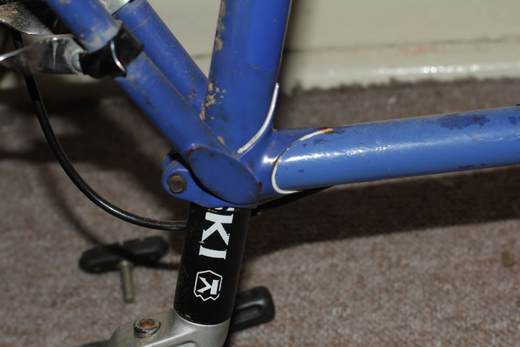

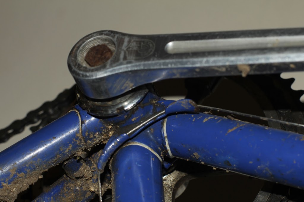

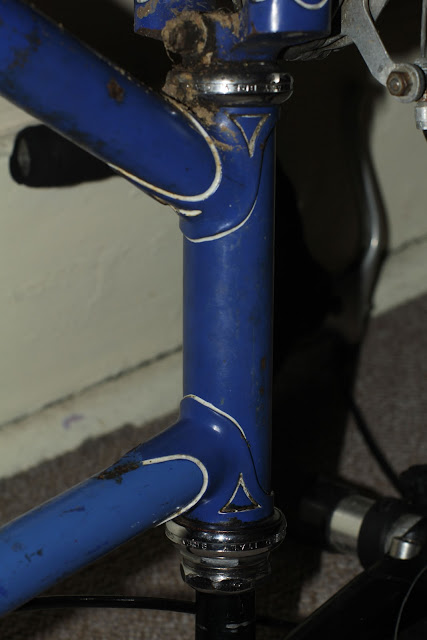

Back to the identifying my frame, he's some close up pics if it helps.
Excuse the dirt, it was just used as a prop for a film project and havn't got round to cleaning her up yet
Cheers
Ouch, that top head lug looks to have lost it's point. The seat cluster and lugs look very Raleigh to my eye. A sympathetic respray looks to be in order having seen the close ups.
