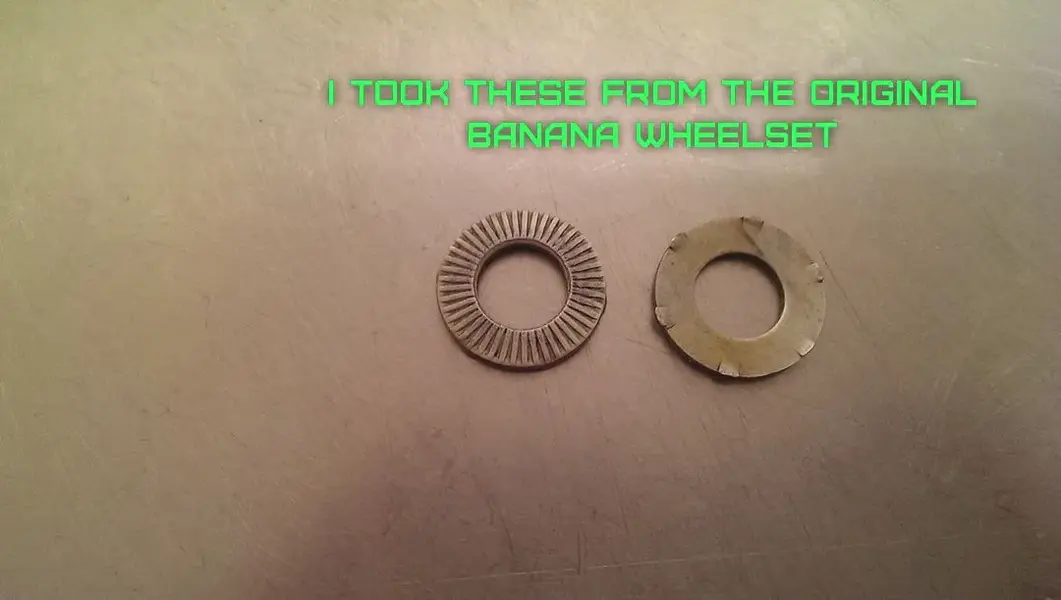

Going with the washer theory (thanks for that!) ;)

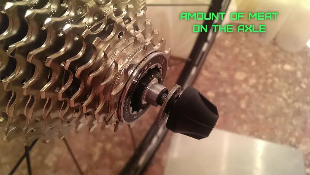

I looked at the original banana wheelset and saw there were 2 washers, one on each side of the axle, so I pinched those and cleaned them up.

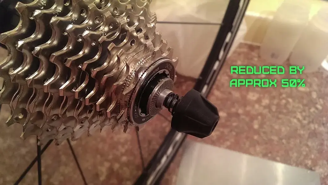

I put one washer on the drive side axle where it seems to be fouling the rear mech converter and tried again.
This seemed to work, I can now tighten the rear QR skewer and all it good and the cassette spins freely both ways.
However, I am not convinced there is enough room for the chain to get by and feel this could now foul the rear mech converter piece, it will be close if passes by.
Some piccies.
Keep plugging away, as you are almost there. You could file down that mech hanger a bit if the chain just skims it.
Great pics BTW.
