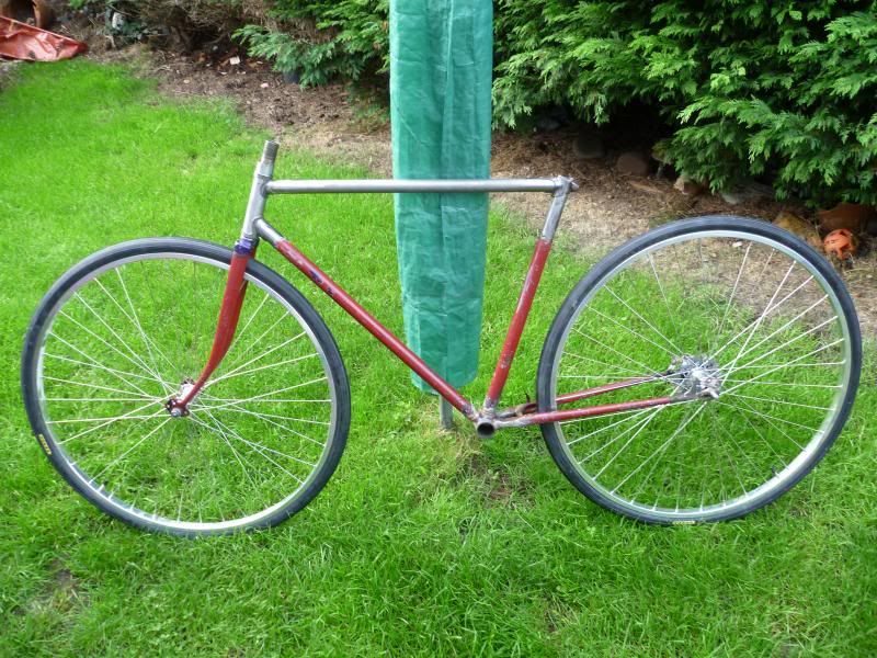

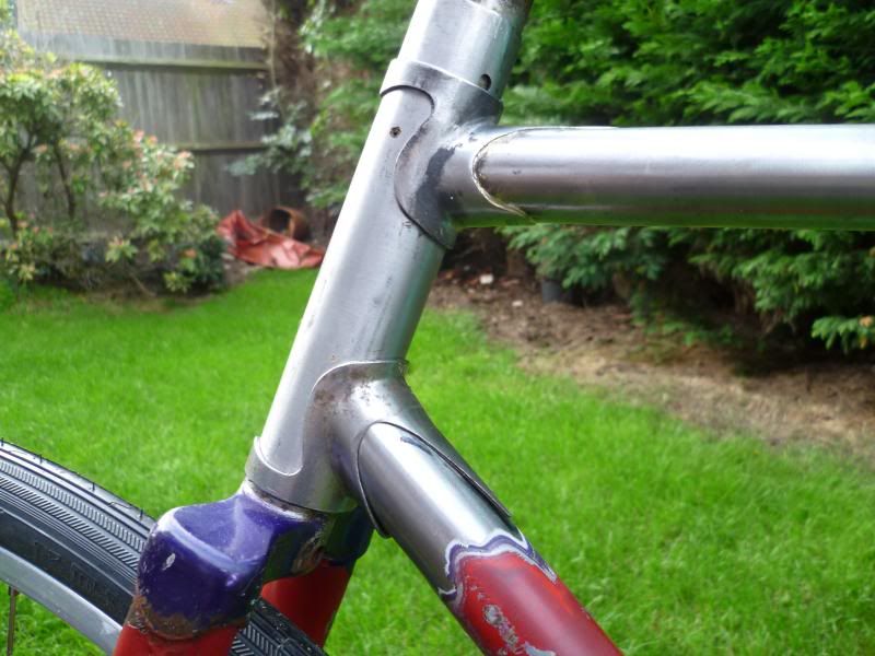

The seat tube is now 21" (Decision here Puch did the 21" Super Sprint in Red and the 23" in Purple, do I match the colour to the size?). The Seat tube lug is silver soldered to the seat tube and the top head tube lug to the top tube and this is my geometry check;
These lugs are not as nice as the Puch ones but will do;
On my home made jig to keep things straight and make up the front tubes this weekend hopefully. Rear stays yet to be ordered from Ceeways.
i wish i was that capable, i'd love to be able to do frame mods etc.
while this isn't a type/model of brand i particularly like but i am very impressed with your work. :D
You're chopping the frame like this and you're worried about originality of paint :LOL:
Nice work though and I like the lugs you're using :D
Have a go it's fun, I started by taking the rusted out back end of my Grandads bike and replacing that with one from an old falcon that came out of a skip, result a tribute to my granddad thats a turbo and occasional use bike. I use spirit levels, tape measures and bits of angle iron to jig things up. I silver solder rather than brass braze so I can use lower temps and a map torch for heat. What I really want to do is mitre up tubes and braze up something completely lugless.
while this isn't a type/model of brand i particularly like. :D
I actually agree with you, it's a heavy old thing without much pedigree, but it's part of my life (my first proper bike) and we've covered a few miles together. I got it back cheap and I can't resist the chance to build a bike.
