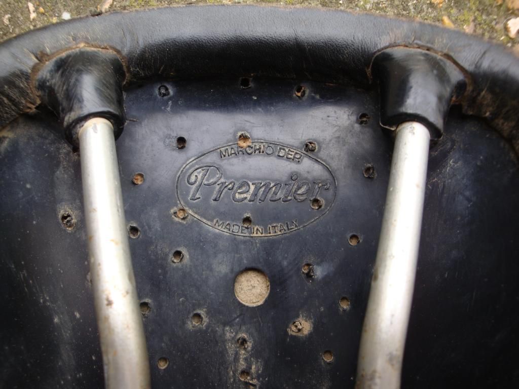

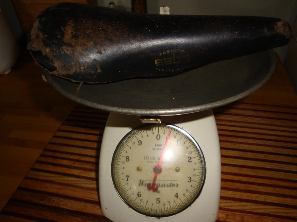

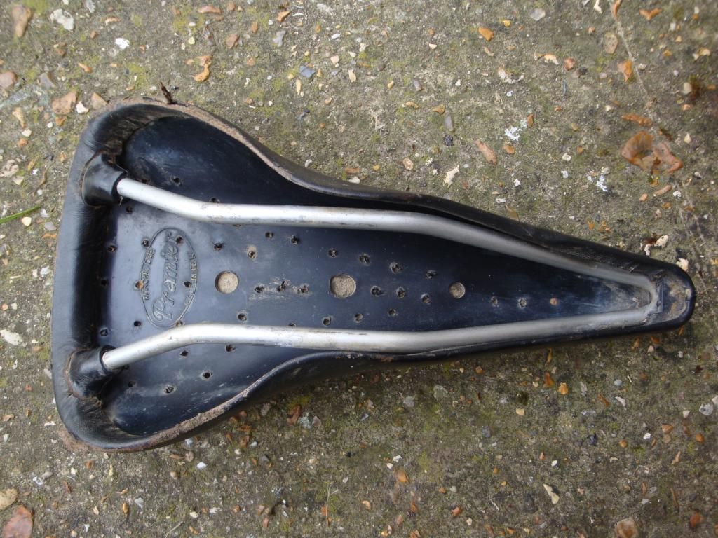

The SABA saddle will be used on the build as its really light...just a tad over 200grams...the base is ultra thin and drilled.Its been said that Alf Engers used one on the speed machine that broke the 50 minute barrier for a 25 mile TT back in 1978.

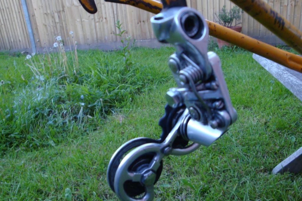

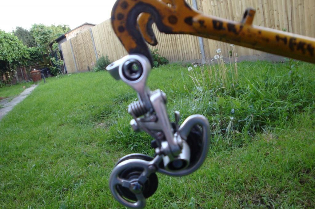

Time for TT machine to go on a strict diet....that big fat lump of a rear mech has gotta go :( parts bin for you...bye bye.

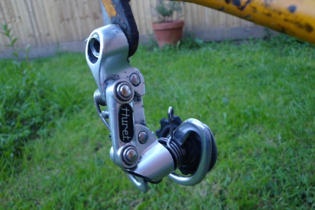

To be replaced with this minimalist masterpiece of French engineering.
Blimey that's real 70's rear mech torture, light as they come but changed like a pig :) Please get the Frame smartened up to match :D
Shaun
Definitely a case of form over function Shaun.I believe this is the 2nd gen Huret Jubilee with stronger springs and beefed up[more weight]cage.Never run one of these mechs before so thanks for the warning.Will be using a 56 ring and 13-17 Regina Corsa at the back....reckon most of my riding will be in 1st gear....a whopping 88inchs.

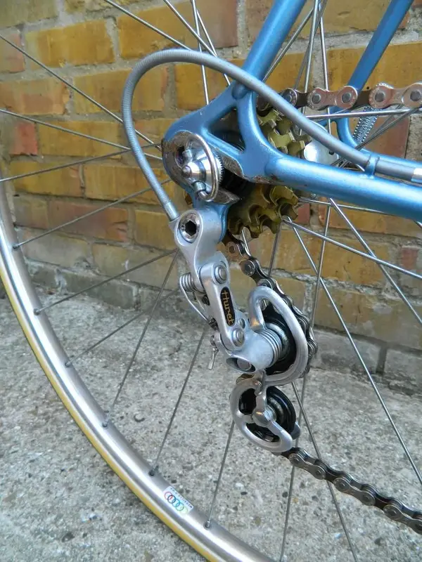

As seen on my 1975 Emperor Sport.
By the way, my Jubilee performs flawlessly with silky smooth shifts! I did set it up exactly as described in the original Huret instructions though, so that may help.
