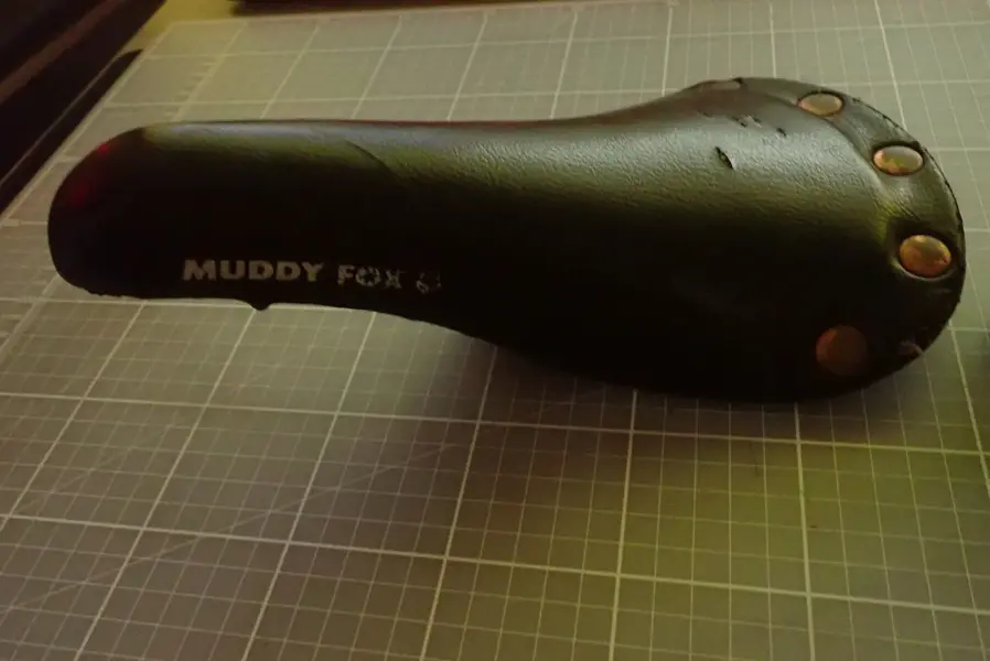

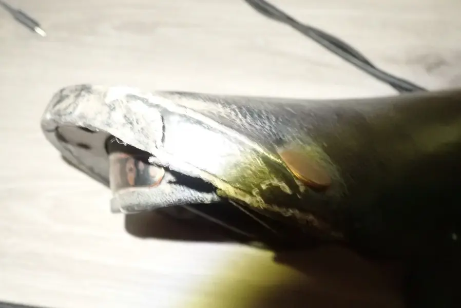

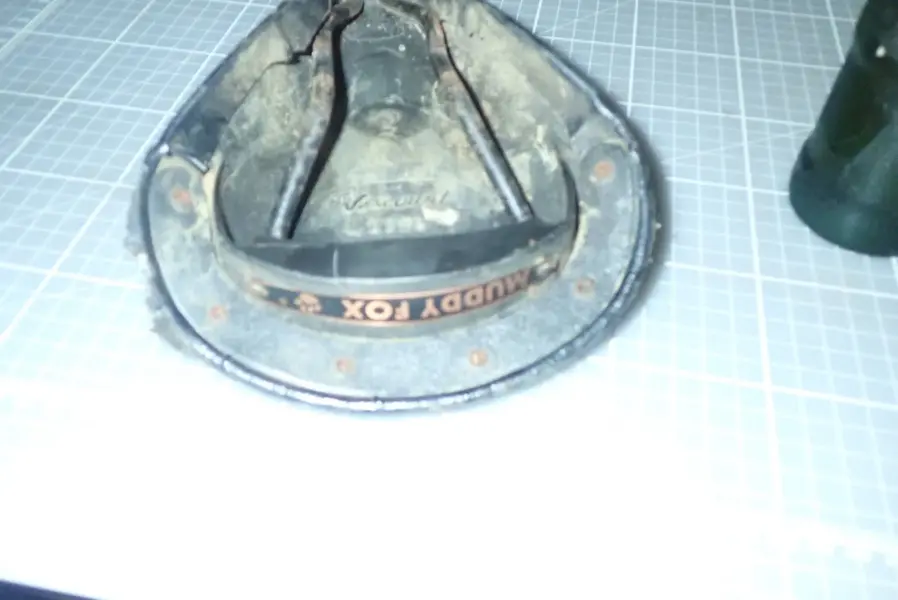

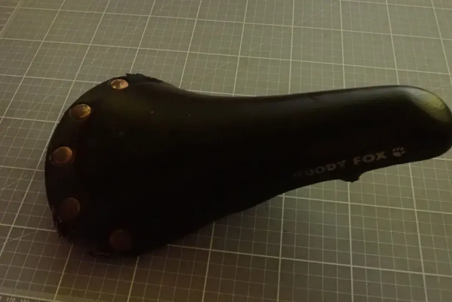

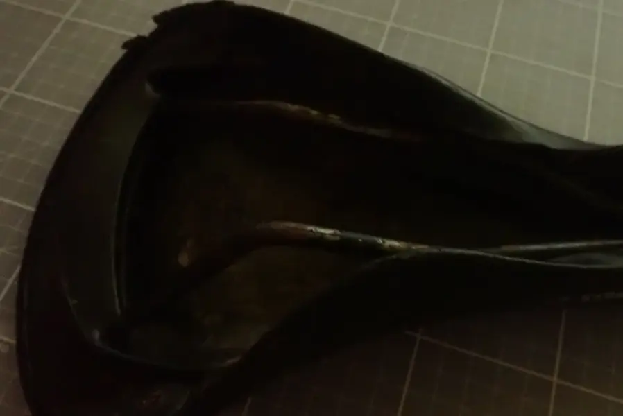

Bought this the other day, honestly I just liked the look of it, and although I am working on a few MF's at the moment this saddle doesn't appear to be a match for any of them. I'd be really interested to learn when and with which bikes these viscount saddles originally shipped.
I plan to restore it and use it with my Monarch Pro build, which when finished will be an unbranded (no decals etc) period incorrect low key daily rider, so the fact that this is an authentic MF saddle is great, but the fact that I will lose the MF markings on the nose won't be a problem.
Having never restored a saddle before I'd appreciate any help and advice I can get, that it's riveted will no doubt complicate things but I am up for the challenge, ideally I'd like to cover it with some type of leather, so any information about what types of leather work best for saddles would be great.
Tried it out this afternoon and I really like the feel of it, it's fairly light and very comfortable so will be ideal for my daily commute.
Here are some pics.
