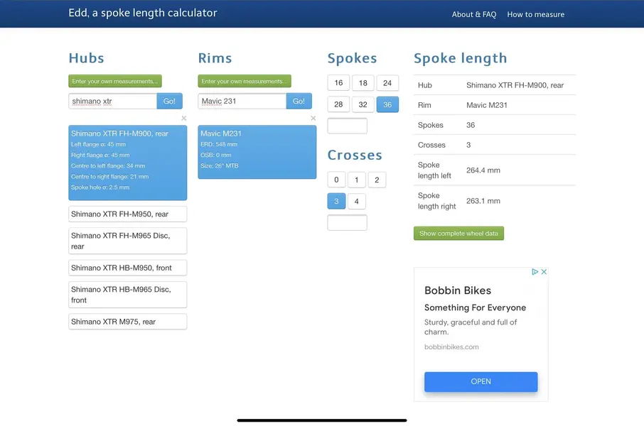

Super helpful. Thanks. DT Swiss spokes come in equal increments. So would I go 264 and 266 ?
Also what about the front please ?

Thanks for the spoke calculator. They are too long the ones I’ve ordered.
Dodged a bullet there. You guys are the best. Thanks you very much. 😀😀

Ah, M231 and Shimano hubs (XTR/XT etc all the same)
I'd be going
Rear (36hole 3x)
NDS (left) 265 or 266
DS (right) 263 or 264
you could wing it with 264 on both side for a lazy build.
Front (36hole 3X)
266 or 267
(go a fancier 2x and grab some 261 or 262's or radial with 256's)
