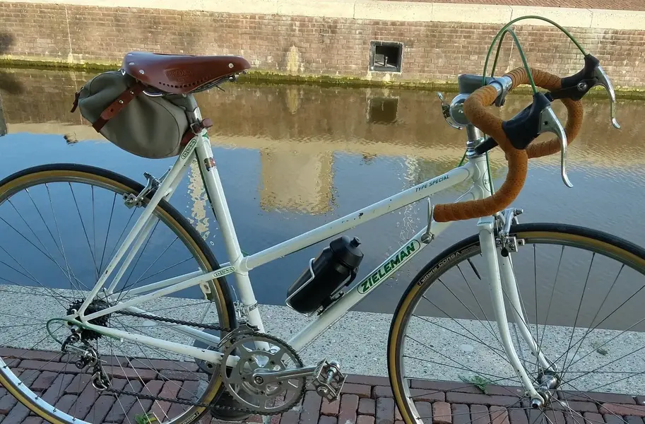

My most recent find: a Columbus SL Zieleman:

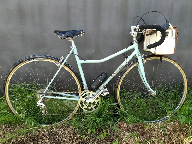

Mrs non-fixie's favourite, however, is this Méral. Designed by Francis Quillon, and made with unknown tubing (Camus is mentioned on the interwebs) she finds it comfortable and quick:
