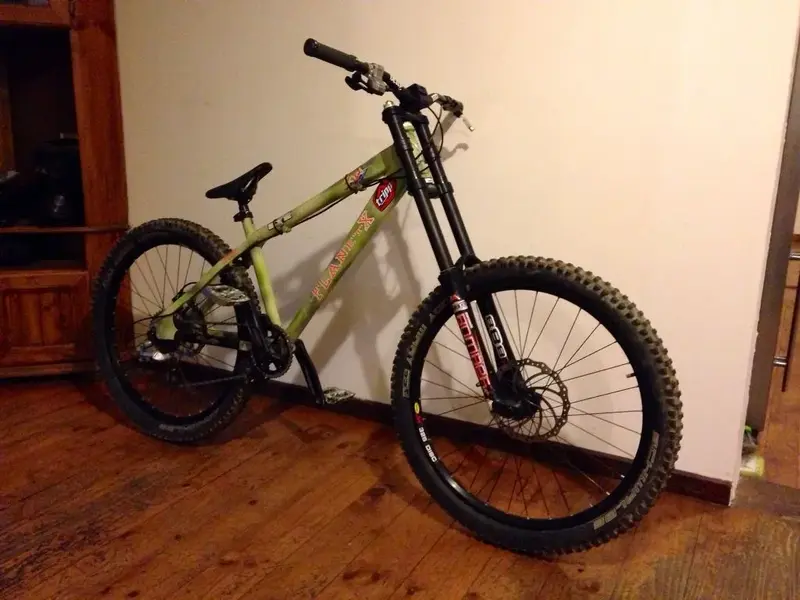

I'm a big fan of that colour scheme with the military style decals too. I though this one was pretty good.....
Yeah, i've found 100's of bikes with that olove drab style colour scheme but I can't find that one single picture I'll nee dto hand over to the frame builder / sprayer. I have a few brake lever / top tube dings to fill, they are barely noticable but I'm wanting to make it look like new etc. I just can't get this paint scheme out of my mind.

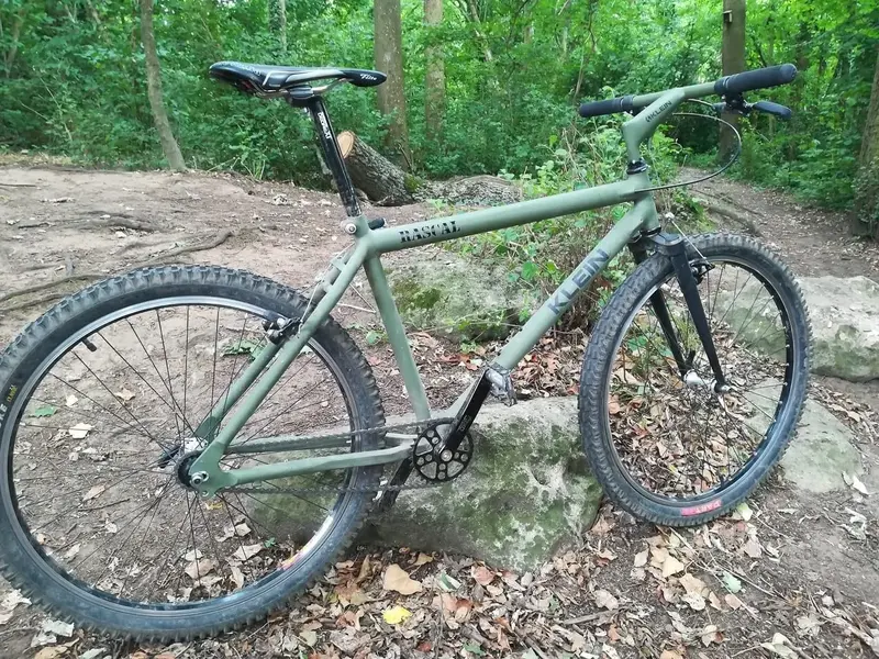

For that look I'd go DIY,NATO paint is cheap and goes on really well use a detail roller the thin 10mm ish ones three thin coats..neat not thinned and you'll be shocked at how good it comes out. If you spray it it wil appear more satin than Matt. whereas by hand/roller It'll have a slight texture a bit like zolatone from a Marin. It's tough paint. I did a friend's VW van years ago looked stealthy.
Black paint pen for tyre pressures etc

Hhmmm food for thought there Mickey, thanks ;-)

Interesting! Do you have a link to anyone who sells that paint? You bad,bad men are giving me ideas now....!

I got mine off eBay...just type in NATO/army surplus paint...from memory about 30 bob for 2.5 litres...youll have enough left over to hide your house😂 its spirit based so you can clean stuff up with white spirit. Use foam rollers not the fluffy ones 👍
