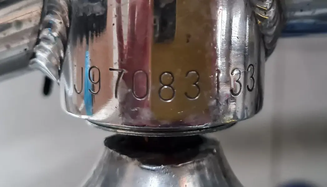

@dyson – how did you get the year from the frame number? I've been trying to figure mine out, with no luck so far, though I'm pretty sure it's a 1996. Mine is K6H01789. I'm just finishing mine off now, looking forward to riding it:
Looks great. I might have thought the silver forks with the silver frame would be too much, but it totally works. Maybe because the black rims/post/stem look perfect, so it all balances out nicely.
Many thanks sjc for your kind comments. It really doesnt work with silver rims for sure! I had missed your thread so I will have a read later. Ill dig out the photo too for you of my frame number when I can find it.
Here is the frame number - J97083133 so presuming August 1997. Not much help though with yours sadly.
