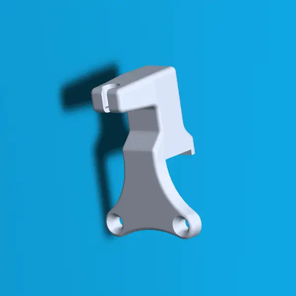

It will be a lost wax casting production, I have seen my 1st wax sample today. πŸ˜πŸ‘πŸ€žπŸŽˆπŸ’•πŸ”§
I think it will sold for not more than 30€.

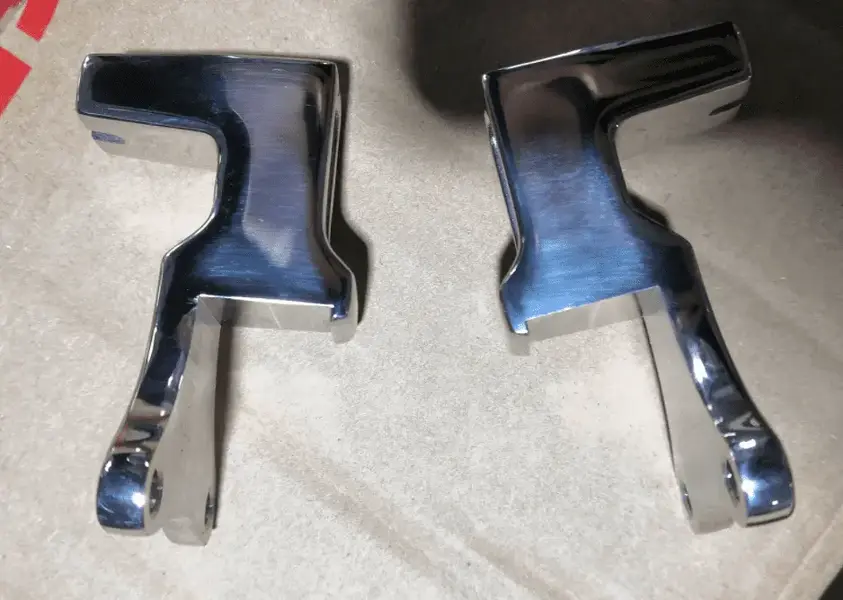

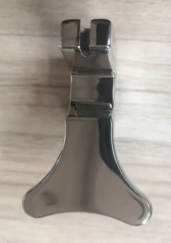

Next Update on my Marzocchi Bomber Canti Hanger Project : We have been through testing Surface Treadment to make it nice!
On the picture you can see the Canti Hanger made out of Stainless Steel in 2 Variants in the left picture :
  • brushed polished (top) vs.
  • mirror polished (bottom) πŸ’Ž.
Right side : polished only.
Make your own comparisment : Here is my Blog post about the first samples, which have been sandblastet and electrolyzed.

Looks good!
Are they being chemically polished?
That's a somehow mechanical prozess, you can see the very fine marks on the polished surfaces.
The part comes from a casting process and needs a lot of work on the surface. πŸ¦ΏπŸ’Ž
I first thought the do rotating polish grinding using some plastic stones etc. but they told me they have machine for it. I always like to see pictures from productions and asking continiously, but often they simple forget it or don't have time for it. πŸ˜«πŸ˜‰

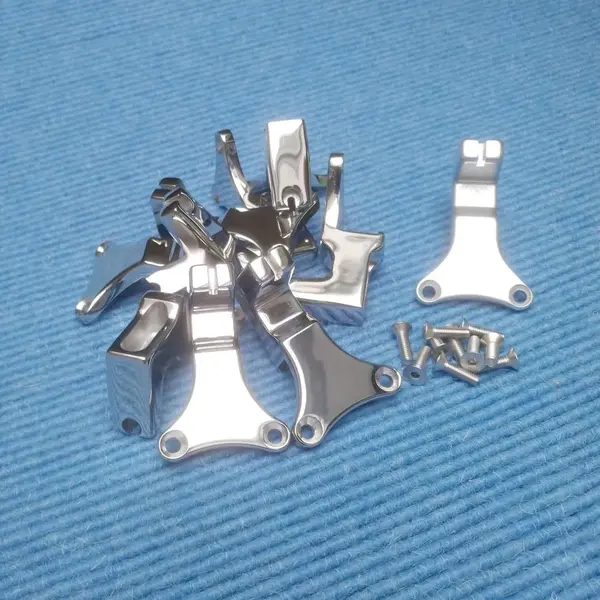

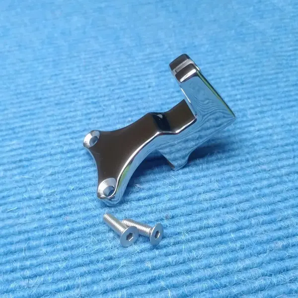

Project finished! Have a look at this excellent results. 🎈
In the 1st picture the one on the right side is an Marzocchi original Canti Hanger.
