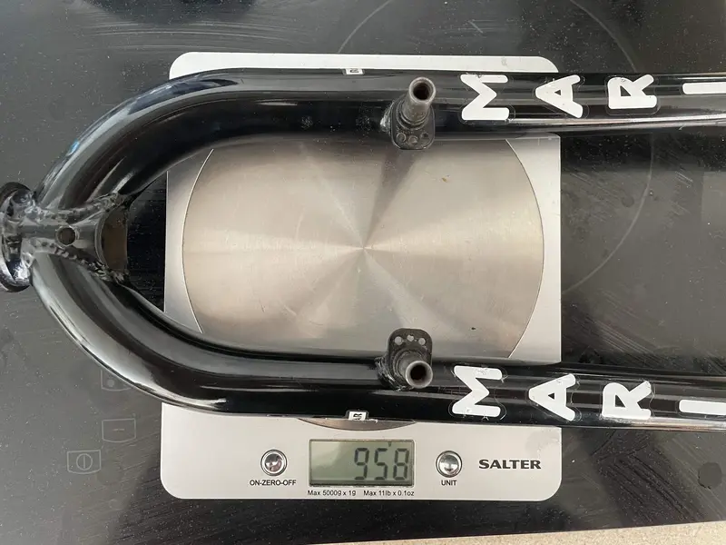

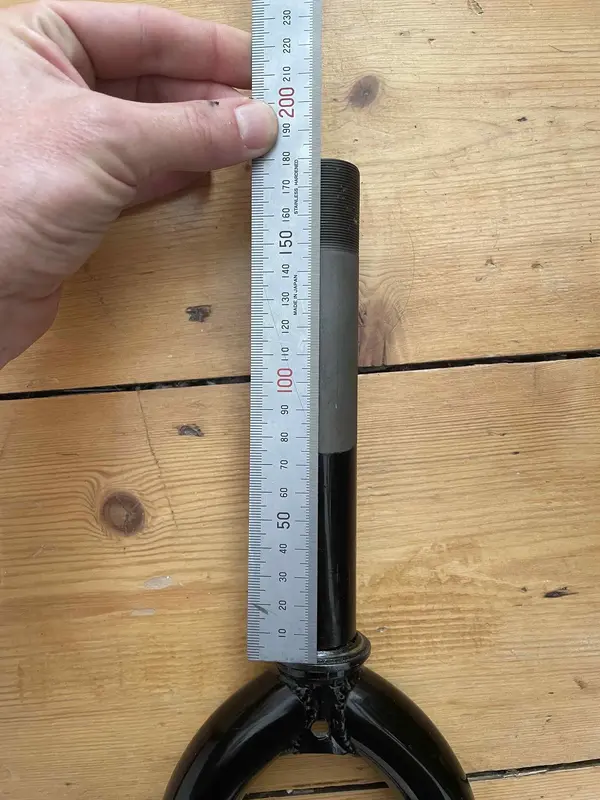

If the steer is 180mm ( possibly 183 ish), that's for about a 150mm head tube, which would be 19" c to c large frame size. Marin seemed to use low stack headsets. Which can be a pain.
750g in 15" small translates up to about 885g at 20.5" xl. They have a 213mm steerer, allowing for a xt headset at 33mm stack.
The non lightweight version at 20.5" for comparison is about 1060g
The lighter version is a better ride as a bit more compliant....probably due to the internal butting and thinner tubing. But the heavier version is far better is you want to add luggage!
That's about right....that's the heavier version used on bear valley etc.
A good fork. Use a modified to ahead set on my daily driver rocky mountain.....nice fork to ride.
