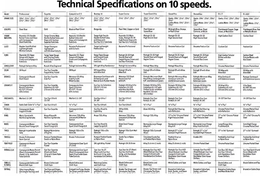

Looks very like a Carlton competition to me. Check the 77/8 catalogue online. Was sold as a frameset in blue or red.
Re: Re:
Thanks for the above info, also found some info on this 1979 listing. Shows Competition GS in Black. Not saying ours is a GS!

Think the gs was an export model, those us catalogs differ greatly to UK products. ;-)
I'd dress it as a Black GS, that Lilac's awful! but at least you've got a steer decal wise....
