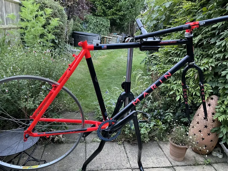

I have perhaps stupidly, definitely whilst slightly drunk, signed up to do the London to Brighton bike ride . And even more stupidly I have decided I want to do it on a 90s mountain bike and to try to build it in about a week . I also want to keep up with my mate who will be riding a proper road bike😬.
I started (yesterday) on a 92 Marin Eldridge grade frame which isn’t in as good nick as I thought it was…forks especially are a bit rusty but I’m carrying on regardless ( if anyone has any better ones they’d be interested in selling please let me know) .
Is it a terrible idea to set it up as a 1x9 for this London to Brighton ? How steep is Ditchling beacon, anyone done it?
I’m trying to use parts I already have, 9 speed stuff and a nice race face 36 tooth narrow wide chainring , modernish deore cranks. Alternatively I also have a shimano grx 2x crankset…any issues with putting something like that on a frame like this? Might appreciate it up that hill…but would need to buy a suitable front derailleur.
I need a seat post too, got one for a previous build at 26.4mm and it seemed a little loose for this frame…is this the correct size ?
Anyway this is the progress so far , please excuse the modern cranks and blue chainring. It’s being cobbled together in a hurry. Any tips on how to make it slightly more road suitable also appreciated IMG_0027.jpeg IMG_0016.jpeg

Nice looking marin btw, only think I can suggest on making it more road is slick tyres larger ring and a close ratio cassette.

I was thinking bar ends might be a good idea, I have some Michelin country rock 1.75 tyres but maybe something even slicker would be better. Which ones do people like?
Just to back up what others have said, 36T upfront with a minimum 32T on the back should be okay up Ditchling – any higher and you're going to suffer unless you're super-fit...

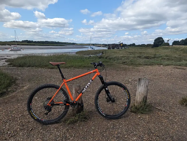

I've signed myself up for the Off-road version this year, but as it's the 1st time I've done it....I will be riding modern 1x11. I'd want to see how it goes before trying retro another year.
Saying that, we used to ride Mountain Mayhem / Sleepless in the Saddle / Dusk 'til Dawn ....short laps on Retro without problems.
My thoughts were comfort for the distance though. Don't think my Retro body would cope with 60 miles in the same way!
Here's this year's choice of ride. It is Steel though!
