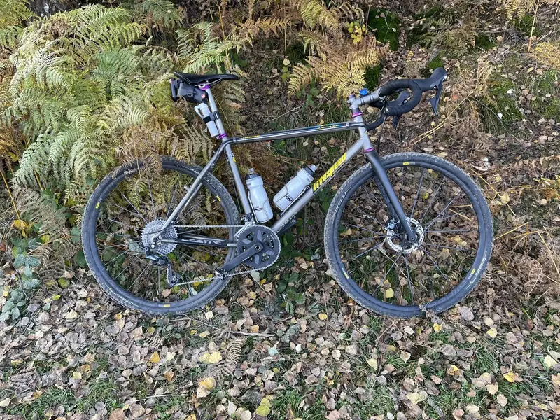

Here is my fool Gravel conversion of a Litespeed Ocoee I bought in december '94.
In 2018 I destroyed my last suspension fork (an old sid modified to have 60mm travel).
And so fork has been replaced with a Whisky part n°9 Cx carbon fork. and the 26' wheels with new 700c Mavic wheels...
After all, I'm happy with this new old bike.
Spec:
FrameLitespeed Ocoee Titanium 1995
ForkWhisky no.9 CX Disc 12 Fork
StemMoots RSL Ti 120mm 0°
HeadsetChris King NoThreadset 1 1/8" purple (1995)
Handlebar3T Superghiaia 440mm
Grip/tapeBike Ribbon cork gel
SeatpostPMP Titanium 27.2 Purple (1995)
SaddleFizik Aliante R3 Kium Open regular
BrakesShimano BR-8070 Hydraulic Flat Mount Disc (Rear with A.S. Solutions IS-FM 160mm adapter)
Disc RotorShimano RT86 Ice-Tech 160mm
Bottom BraketsRotor BSA30
CranksetRotor Vegast 175mm - Offset axle - 46/30 Direct Mount chainrings
Rear DerailleurShimano Ultegra RX800 11V Shadow+ with 14t-12t jockey wheels
Front DerailleurShimano CX70 Top Pull
ChainShimano CN-HG701 11 speed
CassetteShimano XTR CS-M9001 11-40 11 speed
Brakes LeversShimano Ultegra ST-R8020 STI - Hydraulic Disc Brake 2x11
WheelsMavic AllRoad Pro UST Disc
TiresPirelli Cinturato Gravel M 700x40
QR/axleRear: DT Swiss Thru Bolt 10x135 with Reverse Components 135mm 12 to 10mm reducer / Front: Whisky 12 mm NO.9 Thru Axle
PedalsXpedo CXR
Bottle CagesKing Cage Titanium
I really like that 😎

There is a thread, if you are interested, where some other conversions have been collecting... It's sort of a de facto "show me" thread.
I think one thing that is interesting is how fluid the distinction between drop bar mtb and gravel bike is here
Thank you. I didn’t know. And yes, I agree. The distinction with old MTB is even lower.
