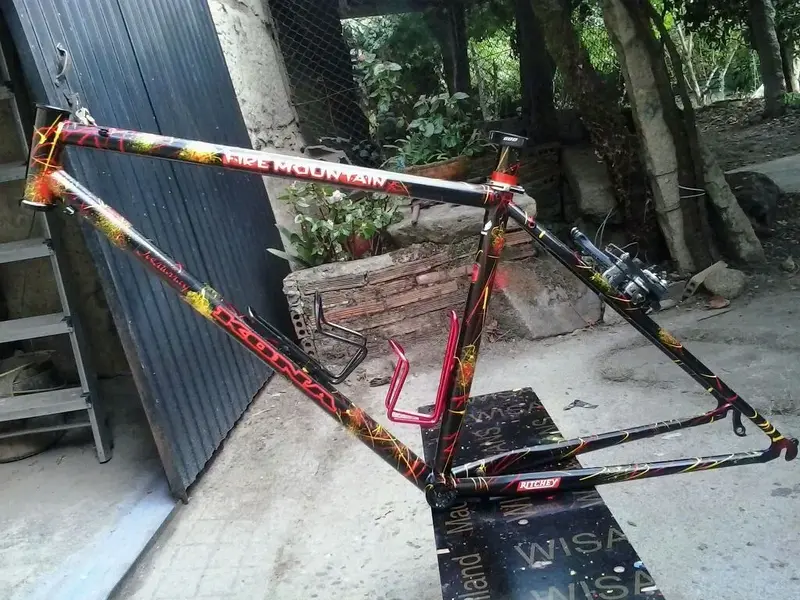

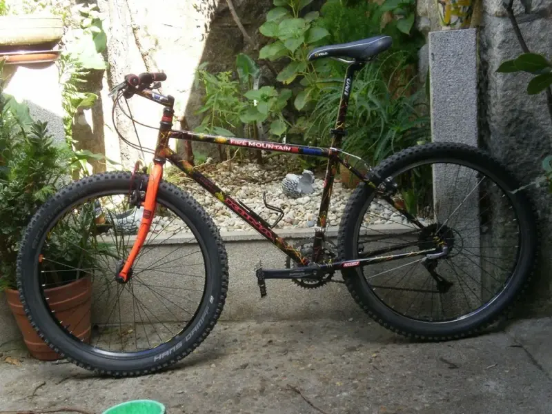

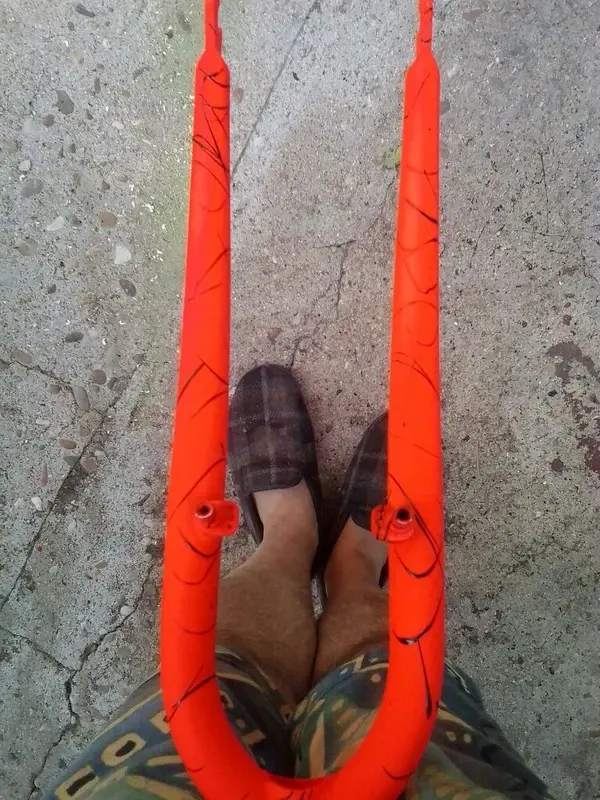

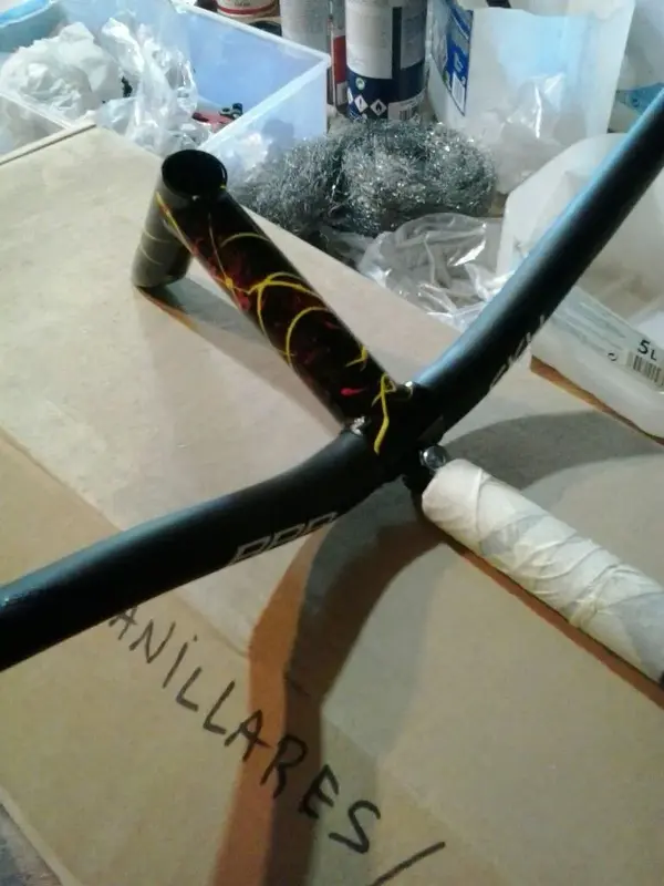

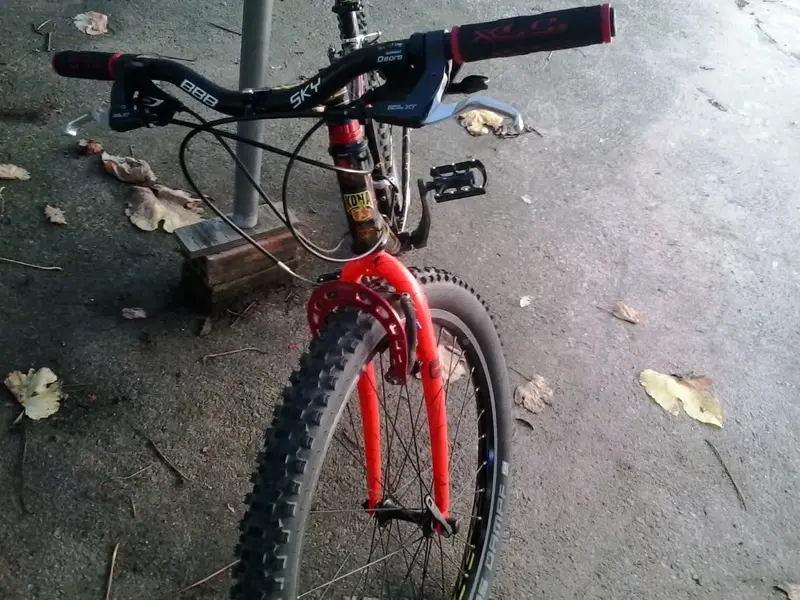

Finished project:
Components:
Frame-Kona fire mountain 1994 tange cro-moly
Fork-Tange double butted cro-moly
Stem-Marin lite without cantilever guide.(130 mm)
Headset-ritchey logic
Seatpost-Kalloy uno
Seat post qr-bbb ring/with bontrager qr.
Seat-velo gel
Hubset, Shimano deore lx 36s front-Migoki 36s Back, dt champion spokes
Rims-Mavic 723 front, mavic x517 back
Brakes-Deore lx v brakes with parallelogram.
Brake levers Deore xt-v
Handle bar-bbb sky
Grips-xlc
Shiftlevers-Front deore, back Alivio 8s
Chain-kmc "z"
Front Derailleur.Deore dx, back Deore lx
Crankset-Shimano Alivio with deore chairings 44-32-22
Casette-shimano alivio 11-32
Pedals-Tioga platform
Tires-Schwalbe hans dampf 2.35 front, Kenda nevegal 2.1 rear.
Bottombracket alivio
"horseshoe"/Gorilla-Megamo sanson-front.
Assembly greases used-Motorex bike greasse 2000(headset, chairing screws and brakes), shimano workshop greasse(for other parts like freewheel body), Moso2 greasse&exustar eg-02(for hubs), finishline ceramic greasse(only as basic for rings and general assembly).

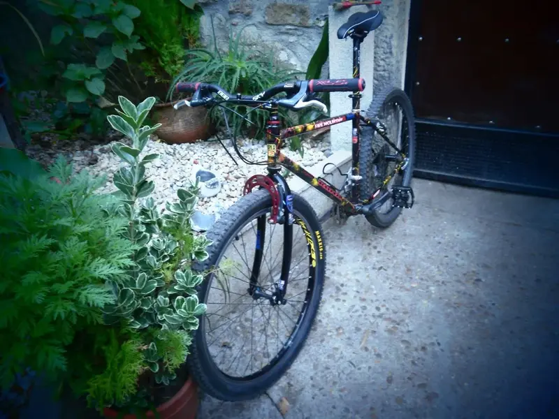

Some update, i had to change the initial fork of this kona to the team marin, because i need to install a wider tyre, and this one only can support 2.2 max. For the kona,s use(skill&recreational use) is enough with this 2.1 in the front, maxxis advantage.
With this one it looks more serious ;)
