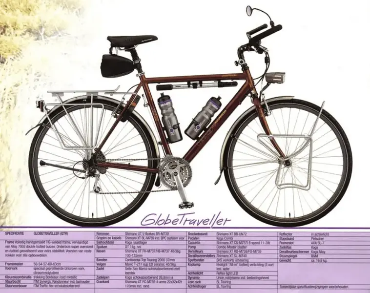

Even though the catalogue that I can view is in Dutch, I can now see there's a few more changes than I originally thought. Some of the others I have seen have an English translation with them; maybe I can find a similar one.
The Seat Post, Stem and Handlebars are different from the catalogue but they may have changed over the life of the bike and they are genuine Koga; I know that there was no set specification with these at the time.
The wheelset is the most obvious change that was done fairly recently with NOS rims. A seriously expensive upgrade but the guy I had it from has owned it from new. I've never owned a set of these in 700c but the quality of them is superb.
It's a completely different ride and set up to that of my Koga Miyata Balance. It feels and handles more like an Audax rather than a tourer. I've fitted 35c Schwalble Marathons due to the shocking state of the roads here but it would probably be even swifter with a set of 32s or better still if you're fortunate to have nice roads, Mondials.

I do wish it came with the original front rack though.
I particularly like the addition of the pump braze-on underneath the top tube. Sad I know but sometimes the little things make all the difference.
