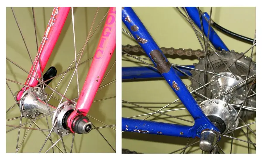

First major problem was a seriously stuck seatpost. That got resolved in the vice, but I lost the Ritchey original that crumbled into bits under some serious pressure, the frame survived intact.
That gave me a chance to assess the state of the paintwork and the rust spots, no holes, but in need of sorting out before it gets any worse.
