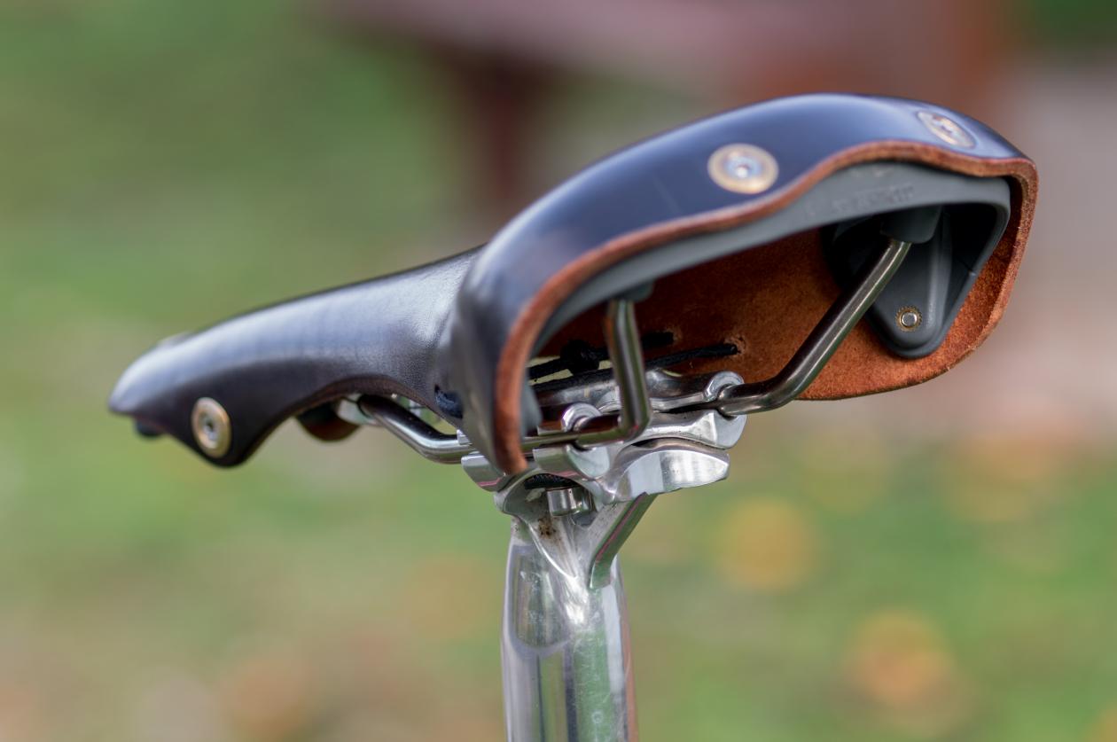

Saddle: Gilles Berthoud Galibier

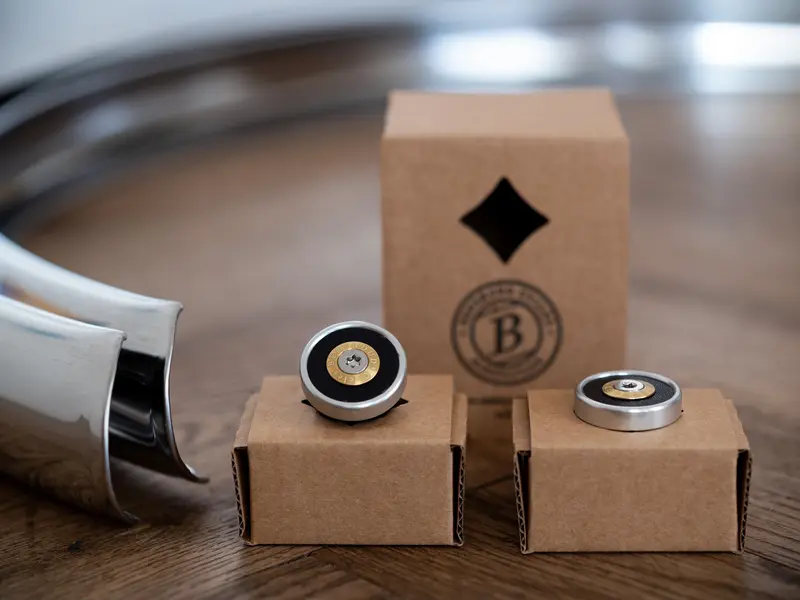

A small modification to increase the stiffness and extend the life of the leather upper
