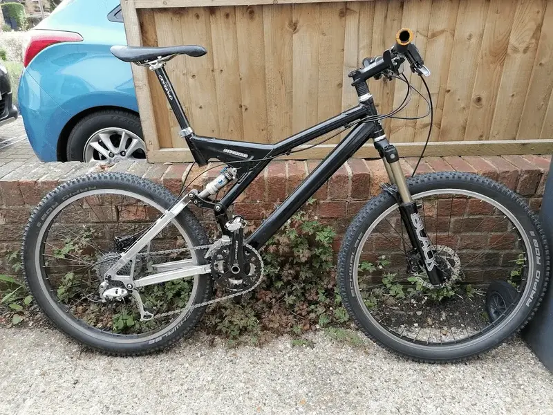

Its too Intense! 1999-ish Tracer

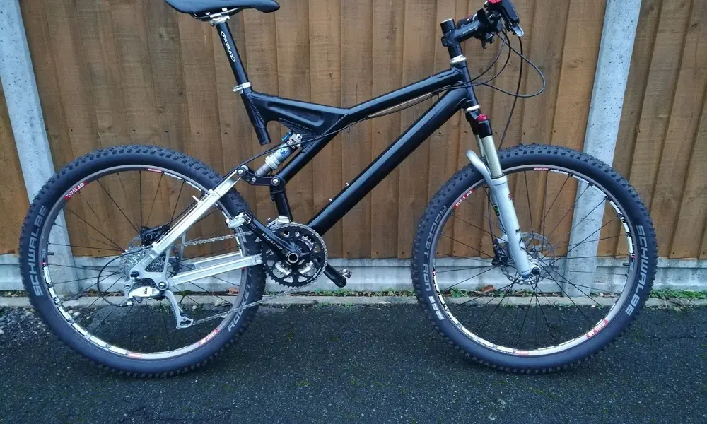

Intensely intensity!
Stole the bits off my Fisher
XT, LX, DT Swiss, with a Manitou fork.
Rides a lot nicer than the Fisher.
Some tweaking to do before its first proper ride
:cool: got to love an Intense, beautifuly engineered and a great suspension action.
The frame looked smaller when you got it, not that i was hoping it wouldnf fit, and i would come to the rescue and give it a home :( , but it looks more your size now built.
Move the shock to the lower fitting to lower bb height/slacken head angle.
Remember you can also adjust the wheelbase via the dropout pivots.
Oh and......(extends hand palm up) ahem ahem....
Looks very similar in design to a specialized fsr. I guess they paid them a license for the Horst link design. They do ride eerily well too. Changing the shock mounts to slacken that angle is a good idea should make a good all rounder.
