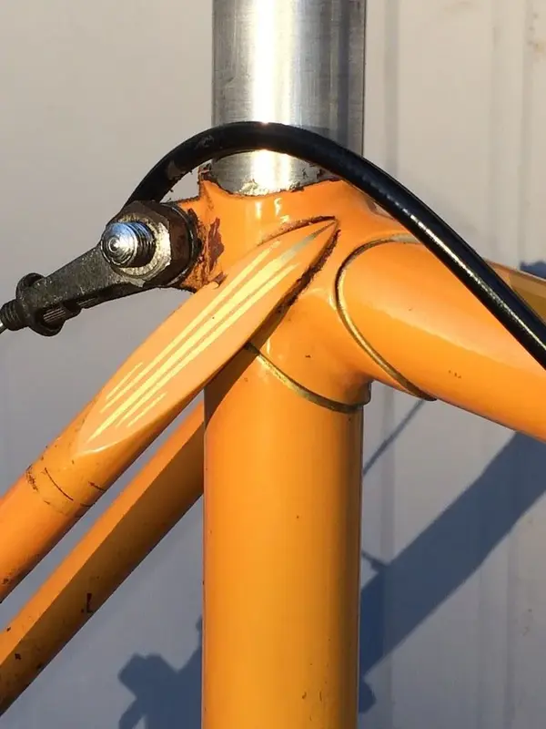

I'll go over the frame once again in the daylight at the weekend but I can't find any frame number *anywhere* on it. Seems surprising but definitely looks that way.

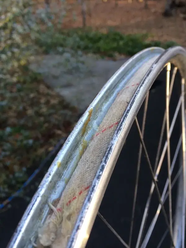

The tyres that were put on were clinchers (27 x 1 1/4) with a max pressure of 65psi. I'll post some picks of the wheels at the weekend but it doesn't look like the rims were designed for clincher tires which is scary... Does anyone know what kind of tyres would have been used at the time and the best way of sourcing something suitable to put on it?

I really want to get this in a shape to ride it. What's the best thing to try to clean the chrome with (eg headset, stem)? Also, if I leave the existing paint job as is, what's the best thing to do about the bits of frame that are showing rust where paint has been chipped off (eg BB, chain stays, head tube)? Should I just clear coat and leave it alone?

I'd think about completely stripping the bike, that way you can inspect, clean or replace any bearings or worn parts. Some parts like the headset bearings, crank bearings, wheel bearings, brake and gear cables plus the chain are better replaced for their relatively low cost and it puts you on a level playing field knowing that everything has been done. Stripping will also make cleaning the frame easier. A toothbrush is a great tool for cleaning combined with squirts of WD40. That will remove any oil, grease and tar spots, a lot of paint marks that look permanent will often clean off. Then as Old Ned suggested a careful clean with T.Cut should put a good gloss back on the paint. I use a dremel to clean out small chips followed by touching up with Humbrol enamel paint and a small size, quality artists brush. An exact match is unlikely but with a few yellows and white you should be able to mix a good match. Nail varnish is also another option but I'd go with enamel on your frame.
Ray Dobbins has a good site with some paint tips: http://www.raydobbins.com/pantografata/ ... ouchup.htm
Once its all complete a good wax will help keep the frame clean. For the chrome (also good on alloy) I use 0000 grade steel wool dripped in oil. This grade is very soft almost like cotton wool to touch but gentle use will remove a lot of dirt and rust spots. Autoglym make a good chrome polish that will also help protect the finish.

The wheels must be clinchers or the tyres would pop straight back off. The choice is a bit limited for the 27 x 1/14 size but I think Schwalbe still make some good quality amber wall tyres. They have to be amber wall :)
It depends how perfect you want to be but you can also completely strip and clean the calipers and derailleurs. Where you go with the wheels will depend on how good they are. If you're looking at new hubs they have to be rebuilt which will be worth it if they are original, otherwise you may find a better complete replacement set.

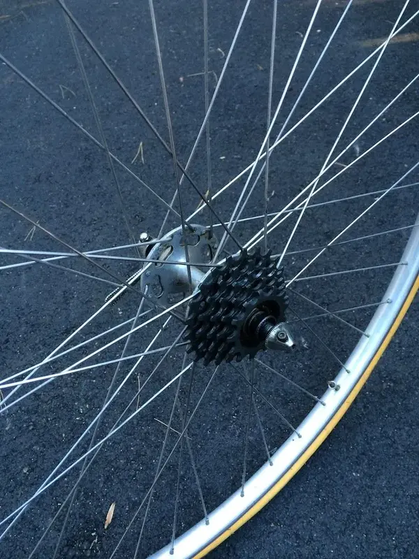

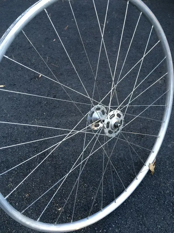

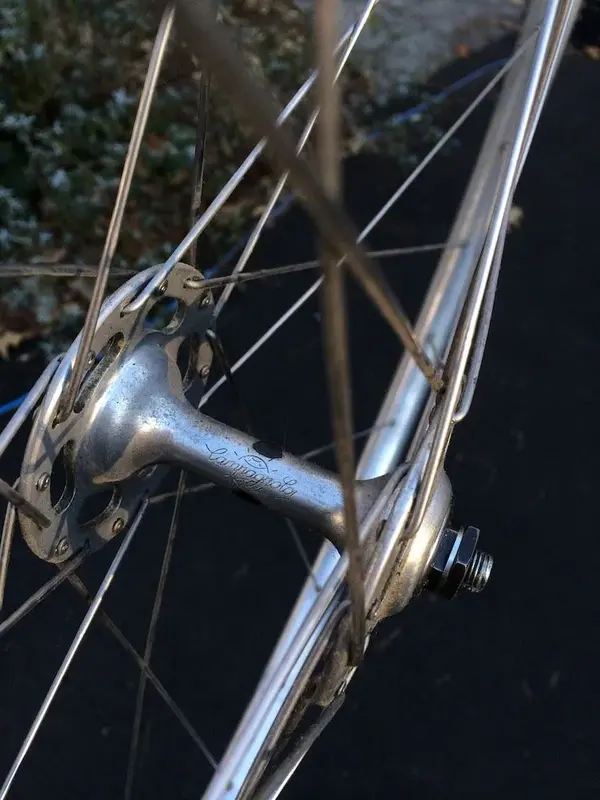

Thanks for the input and tips so far. I took a few more pictures at the weekend. Wheels are Campag large flange - 40 spoke rear / 32 front (makes my modern mavic 20 rear / 16 front seem laughable). 5 speed. The rims look like there are some last vestiges of old glue on there but the fabric rim tape is unlike anything I've seen. Although this had clincher tyres on it, there's no bead seat for a tyre (hopefully it shows in the pics) which means it was probably a miracle that the tyres stayed on...
I definitely can't find any form of serial number on the frame as is, so will leave it well alone, start by stripping it down to clean and see if I can get it rideable over the course of the winter!
