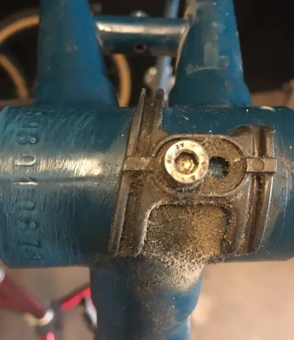

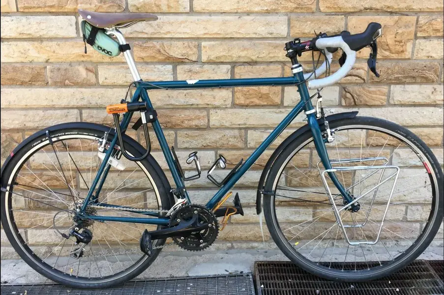

Would you be able to help me narrowing down my search on this Randonneur / touring bicycle?
What I’ve got so far is rather slim
• No brand name to aim for
• Heart shaped stopper for downtime shifter clamp
• Cable stops might have been added later
• Rear spacing is 130 / 132,5 all the way back with lots of tire clearance
• Fork is stamped with Spinner 1993 and 955g and it has CL-1 Lowrider eyelets for Blackburn CL-1s
• Frame Number is S93010879 which makes me think it may be a Brand having produced more volume
• Frame weighs in at 2680g in a 60 C-T
• 26,6mm seatpost and 1“ headset
• Frameset was equipped with a Campagnolo Racing T Triple and a Stronglight JDX94 Headset, Technomic stem and powdercoated in greenblue.

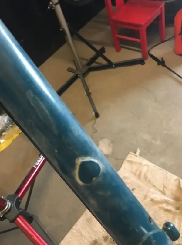

I would suspect either Thorn (SJS Cycles), Spa Cycles or Orbit. Try also the Cycling UK forum (used to be CTC) as it's exactly the sort of bike its membership rides.
Thorn for one often spaced frames at 132.5 to enable wider hubs for stronger rear wheels.
Cheers! :D I will check out those brands and have opened a thread in the Cycling UK forum.
The heart shaped boss is an interesting feature. The plastic cable guide under the bottom bracket, what look like threaded mudguard mounting points on the chain stay and seat stay bridges and the general look of the frame make it seem unlikely it was ever built with band-on gear levers in mind. I suppose it's a well hidden way to give owners the option to use down tube gear levers without having to use braze-on mounts but could it have been for some other use?
There looks to be a dynamo wiring hole in the down tube near the head tube and the frame seems well thought out for touring use. The 26.6mm seat post and quite high weight of frame and forks suggest heavy duty generic CroMo tubing rather than anything exotic which would probably rule out Thorn or Spa.
Having three cable guides for full outers in that position on the top tube ought to be a clue because I can't recall seeing them like that before. My money is on it being continental rather than English.
Mark.
Mark.
Hi Mark,
thank you. That's more or less what the chaps at the Cycling UK forum have been saying.
More continental i.e. German or French than English.
Internal wiring for Dynamo and lights is a more common thing there as its never been a legal requirement in the UK. Which I never thought of.
I can only confirm that this is a superb (thought out) touring bike and also fast despite the weight of the tubing. I was in the Vosges mountains in France last year touring with fully loaded front panniers and it was excellent on the climbs and even better downhill.
Narrowing down to the other side of the channel :)
Cheers
Dominic
Riddle Solved - A German after all
Thanks to all who have helped in narrowing down what the Mystery Randonneur Touring Bike
Its a frameset by VSF Fahrradmanufaktur in Oldenburg Northern Germany and it is identical to their early 1990s Trekking linup. Frame is from Tange 5 with silver as a binding metal - not sure what the exact English terminology is here? solder?
Not sure if happy or sad, as I really hoped for an English bike :? The company still produces good quality touring and randonneur bikes, but is now owned by Prophete.
just glad its an early model :D when they were still a cooperative of independently owned bike shops. No chain or big global brands back then.
