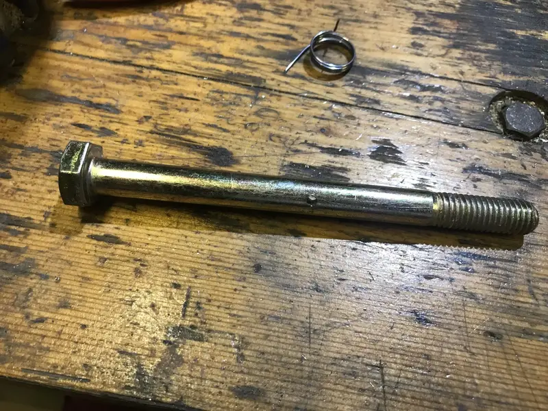

2) It took a while to work out the right diameter of mandrel / form to wind the wire around, as the spring expands somewhat after winding, so the mandrel is always smaller than the spring you need. For these, I settled on a 10mm diameter "thing" to get a 15mm spring (the actual spring was 13.8mm). The “thing” in this case was a bolt with no thread in the middle but could be anything solid and cylindrical. It turns out there’s an equation and online calculator for this and it confirms the results.

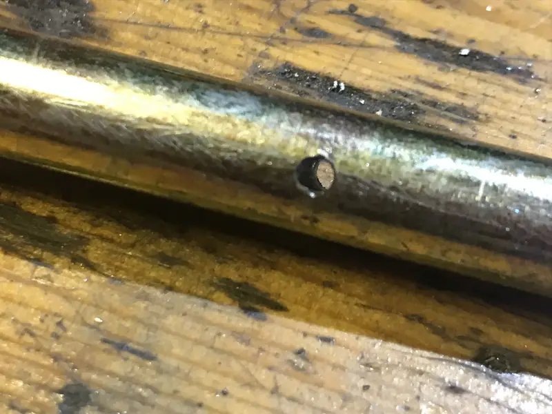

3) Drill a hole in the bolt (or whatever you're using). Doesn't really matter where.
4) Take a length of the piano wire, about 20cm and clamp it fairly tightly between two blocks of wood in a vice, with just enough poking out to go through the hole in the bolt, a bit like a thread, waiting for a needle to be poked through.

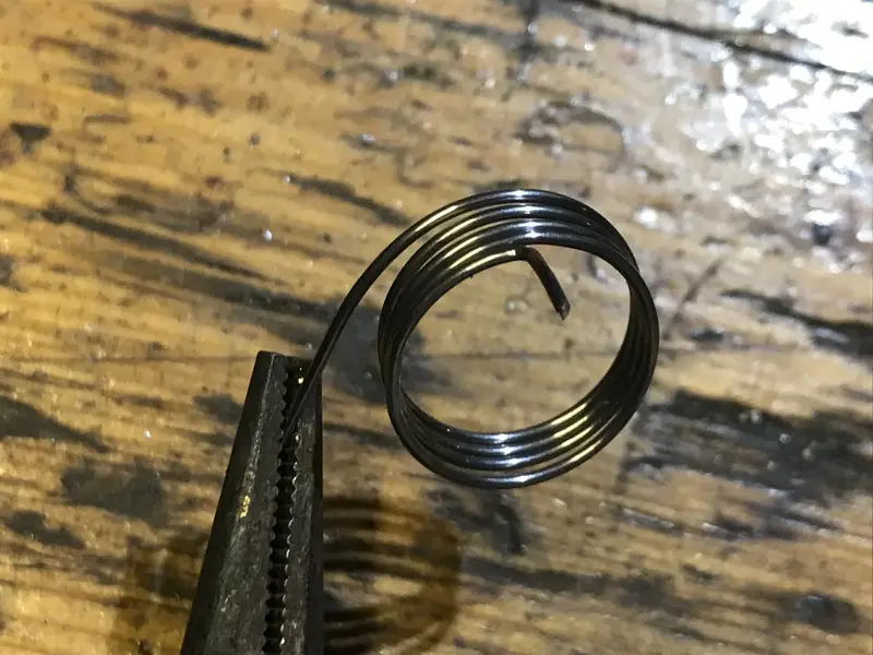

7) My spring only had 2 main windings but I created a spring with 4 or 5 so that I could cut it where needed.
:cool: Keep checking with the original spring and manipulate your new one to match. U used needle-nosed pliers to bend the ends etc. Luckilly I had a relatively good spring from the other lever to compare to. In the end, I assumed the spring got a bit stretched over the years so corrected that in the new spring.

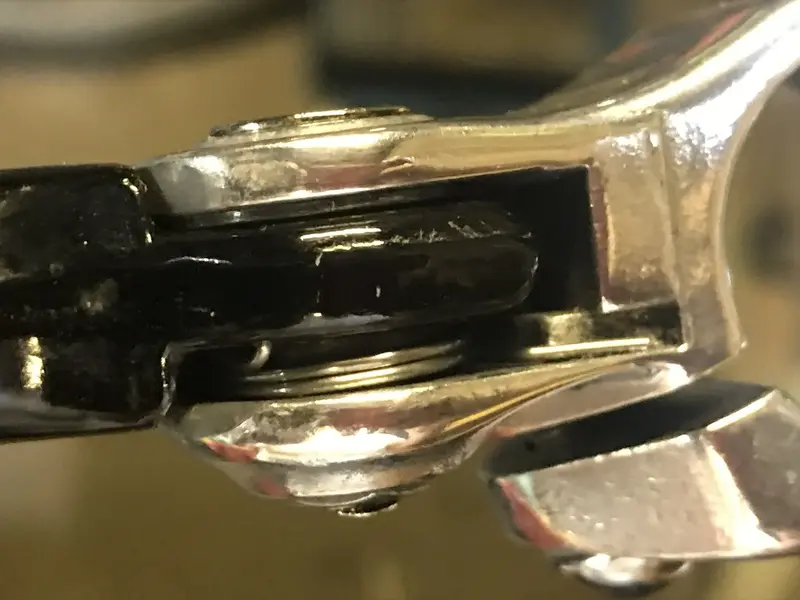

9) You're done. See second image of it installed, it's near the bottom of the image.
