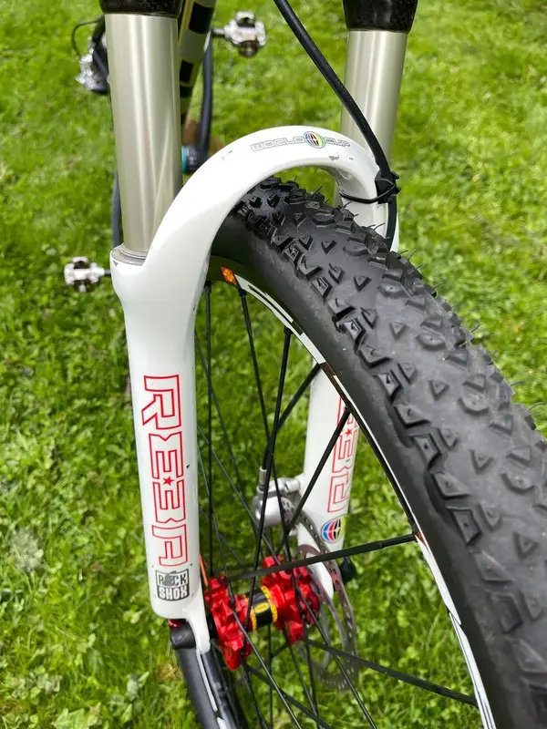

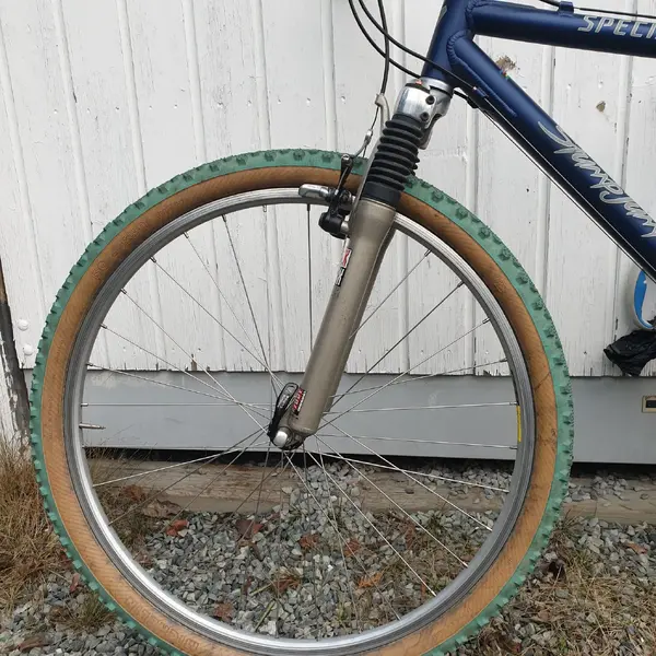

Have a 1996 fs m2 with " stock' Judy Xc and I bought a donor bike for parts.( yeti asl) Question is how much will the travel length from the Reba with 10cm change the ride quality?

The axis to top of crown height of the Reba will be approx. 4cm higher compared to the Judy.
That's to me a bit too much as not just front height but also bottom braket height and angles are slightly changing too.
Also the center of gravity is moving slightly up and back.
Others may say it's still OK, you may not notice a negative impact.
End of day you have to try it and decide on your own...
Newer Rockshox forks do have so-called all-travel spacer, maybe this one too, but you have to check.
If so, by adding additional spacer the travel could be adjusted to 80mm too.
+\- 10mm A-C change = ~ 1deg change in geometry from ‘std set up’. Too much ^ in A-C = more Chopper like handling or increased steering/handling ‘Twitchiness’ if vice versa. As member above, I have experimented and geometry has a huge effect on how a bike rides/handles.
indeed if you want to use a more modern suspension fork in an old bike I would recommend to first of all look for one with very low A-C height, like SID before ~ 2000 with 63mm travel, which is depending on exact model just 455mm, or Skareb/R7 with 80mm which are also just 45-46cm.
Than also run those with as max as possible SAG, that the A-C difference compared to old fork is <2cm.
But some users may say that by having a higher fork you get not just more comfort by the better performing fork, but also better comfort as the front comes higher and even a bit more modern geometry with more rake, better for higher speeds and downhill.
Also objectivly our bikes from the 90ties had a rather race and uphill oriented geometry, which isn't fitting every rider (any longer).
Still, as other said above already, too extreme changes may lead to an negative impact on riding handle.
