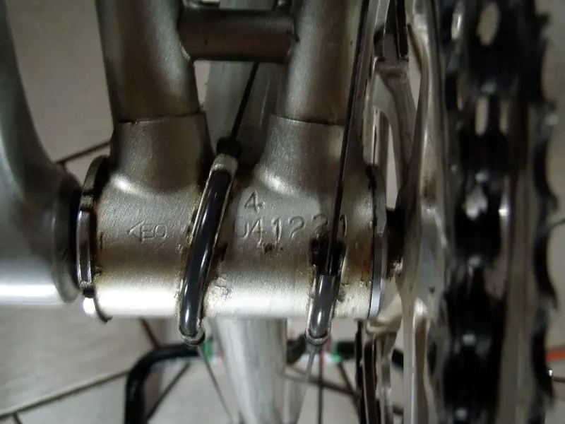

1982 Holdsworth Nuovo Record frameset (identical to one in the '82 catalogue) - bought this frame in March or April that year - if I remember correctly from 35 years ago!
Frame number 041221
Cheers, Dave

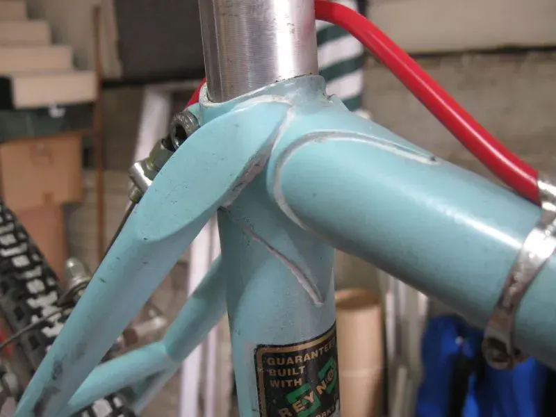

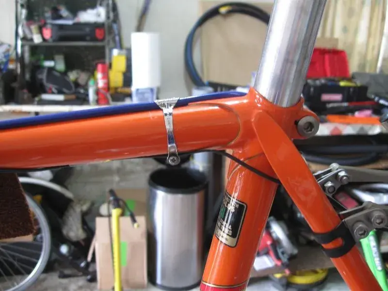

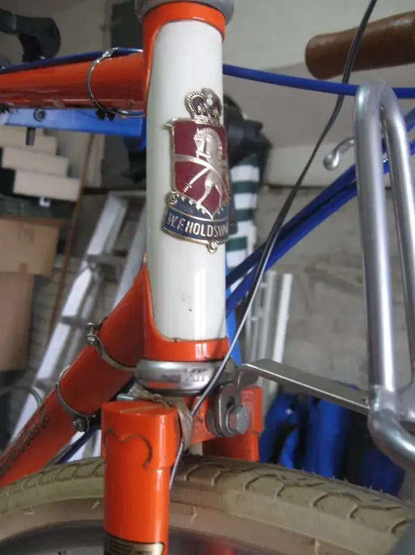

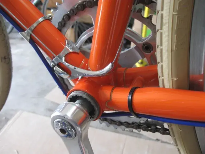

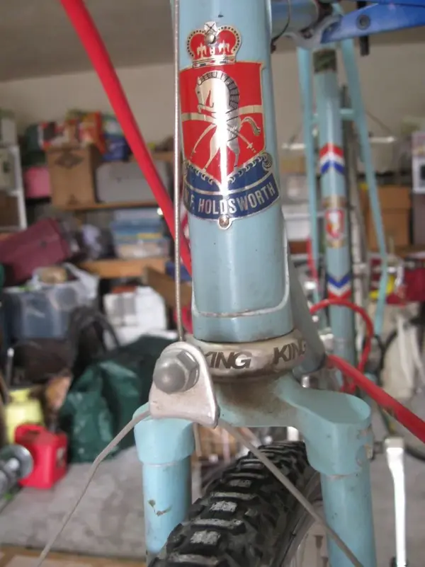

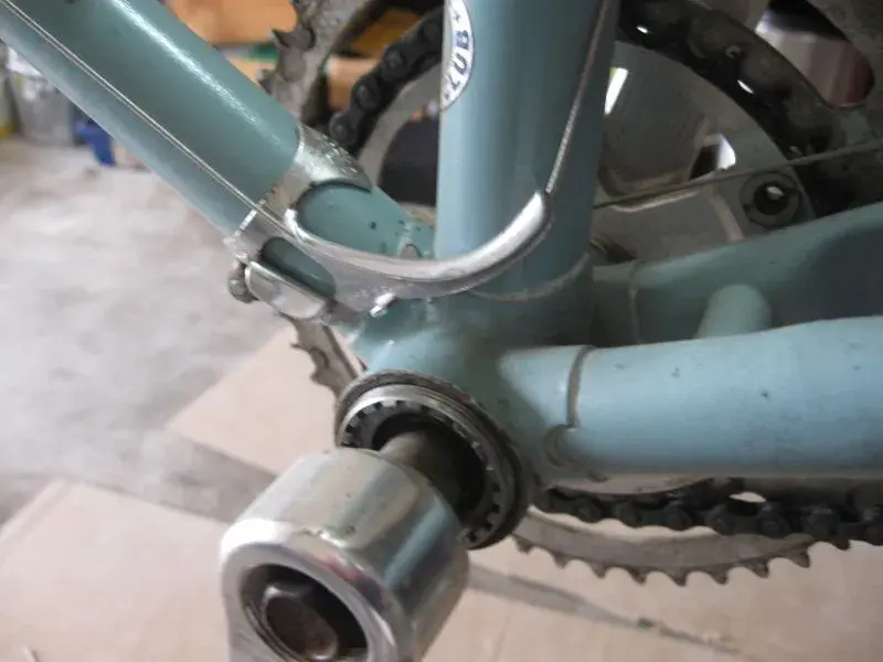

Hi Doug,
As far as the tubing goes for either frame, I am completely in the dark and not expert enough to be able to spot the difference. Both frames were purchased on eBay. I'll attach photos I tool of the lug work and fork crowns. It takes a 27.2 seat post. Note the odd head badge. I really didn't know what to make of that when I got the bike. I have one of the older Holdsworth headbadges, but this one is altogether different from any I've seen. It's one of the things that had me really scratching my head over this frame. I have loads of fun on this bike though all year around.
- Eric

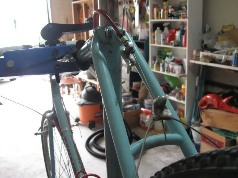

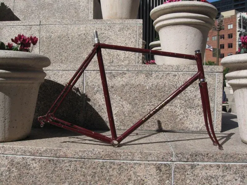

Pictures of the other "shop" frame 69364. The head badge did not come with the frame, I'd purchased it separately. Attaching a photo of how it looked when I received it. It hung in my garage for about four years before I got a bee in my bonnet to do something with it. The water bottle bosses were added when I had the frame re-painted.
- Eric
Frame number 041221
Cheers, Dave
Thanks for the number, not had a Nuovo Record with a 'good' date, this will help to place the others in that year as they all have similar numbers.
Hi Doug,
- Eric[/quote]
Hi Eric,
Re 69387 and pics. A 27.2 seats-post suggest 531DB tubing and in my mind less likely a Competizone as apparently had plain gauge Reynolds and was not made to custom specs. Also this frame has a semi-sloping fork crown and semi wrap around seat stay caps that suggest to me not the more basic Competizone. I am not sure what to call this. It must be a custom "special; and a "cyclocross" style frame and as previous the serial number style suggests a Tommy Quick build who in early 70's when this frame was likely built was the shop "specials" guy. During the shop years that are certainly lots of special frames built that don't seem to fit a particular model. I'm not sure I recognize that style of head badge but it appears to be similar to head decal that Holdsworth used in 80's. Does your c.1986 Gemini (Marlboro) headset have a similar badge? Maybe others will have more to add re 69387.
Doug

Hi Eric,
RE your 69364 "shop" road frame, also wonder what size seat post it takes - as you say easiest way to decide whether might be 531DB or not? I'm no expert re tubing type either. Still wonder if might be a Competizone which was said to be plain gauge. Certainly nothing to suggest a higher end Italia/Strada with flat Wagner crown and more ordinary seat stay caps. Prugnat S lugs do suggest a "better " frame but from what I have seen "shop" seemed to less consistent re lugs used. I was mistaken with previous dating, as per Dave's prediction table both these frames date to circa 1972. I edited in prior post. Again, maybe others will have more to add.
Doug

Sorry I forgot to add that. It's a 26.8 oddly enough. Gave me some serious headaches during the build as I could not get a good measurement with my calipers. I assumed it was 27.2 and was wrong. I had a lovely aero Campy post I was going to use, but it didn't fit. Also, my Gemini tandem has the standard 1980s head badge decal.
