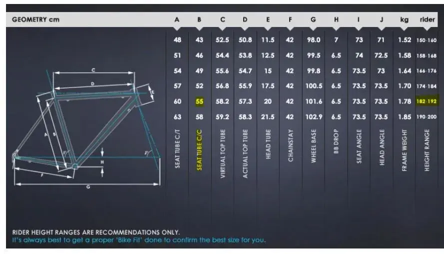

Well, I just bought a road bike. I did all my homework on geometry and the 56cm Cube the shop built for me was too small. The 58cm fitted like a glove, but was carbon and Ā£750 more but the same components (105). I went to shop no. 2, took my existing bike and they the set up the various ones I was interested in the same. Two Giant models in M/L felt radically different. I chose the one that fitted the bestā€¦
I learnt a lesson here, on paper and in reality are very different!
So I bought the 22ā€/56cm modern-ish bike (this one is from 2012 but the same frame was available in 2009)
Itā€™s actually worked out to be a comfortable ride. And although aesthetically Iā€™m not so sure about how much seatpost Iā€™m showing, the seat/bars/cranks are in almost exactly the same position as on my 23ā€ 1962 Touring Claud and although obviously they feel worlds apart when cornering/climbing/descending, actually on the flat they feel remarkably similar.
I might still keep an eye out for a 23ā€ version though. šŸ˜œ
