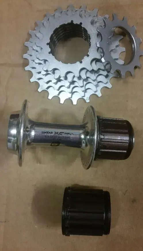

Pretty certain I have a spare nos non md xc pro freehub, see pic below.
That sounds super helpful - which splining version is it? Obviously the pic is of lots of bits, what is actually spare? I’m sure I will relieve you of it if it solves my issue!
Pretty sure it doesn't have the indexed spline, the pictured cassette fits it. Pic was just one I had on my phone.
So I was wrong, it does have the indexed spline. The cassette in the previous pic fits it despite not having the indexed part.
In theory you latest cassette purchase should work with it.

Re: Re:
Amazing - how much are you looking for for it? :)
Just wanna build the damned bike now :D
The raised bit is just narrower but the 'narrow' lower ridges are still in the same place,
Hence why the old style cassette fits (that cassette is the version he needs).
Buy it all and then look for another shell with what's left, hahaha
That's a newer freehub body so yes will work.. as long as it is not microdrive.
